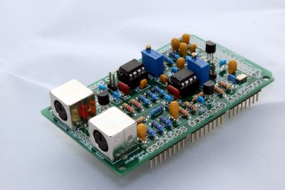

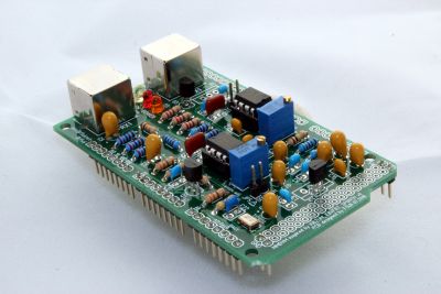

MMDVM Board
The MMDVM is intended to be an open-source Multi-Mode Digital Voice Modem,
which utilities the power of an ARM processor and a simple analogue interface
board. The Multi-Mode Digital Voice Modem is a combined hardware and software
development of a modem to handle all amateur digital voice modes. Initially
it will support D-Star and DMR, with System Fusion and P.25 coming later, as
well as a built-in FM repeater controller. For all modes other than DMR and
FM, the modem can be used in simplex or duplex mode, while for DMR and FM
full duplex must be used.
MMDVM Board (old version shown)
fitted to an Arduino Due
The MMDVM is aimed at the Arduino Due, Teensy 3.1/3.2 and mbed platforms, the
only requirement for the hardware is to be ARM Cortex-M3, M4, or M7 based,
and access to raw interrupts and ADC and ADC ports as well as digital
signalling ports.

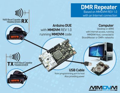

这是一个开源的多模式的数字语音调制解调器,可以通过改装普通带9600 baud packet通讯接口的模拟中继可以实现数字通讯差转,可实现多模共存,目前只支持D-Star DMR P.25 C4FM,比如2720 GM300 GM338 GM950 7900 等等可改装。

简单的说就是模拟中继加这个板子实现DMR P25 C4FM D-STAR等数字语音差转。而且可以实现一个中继台几种不同模式工作。

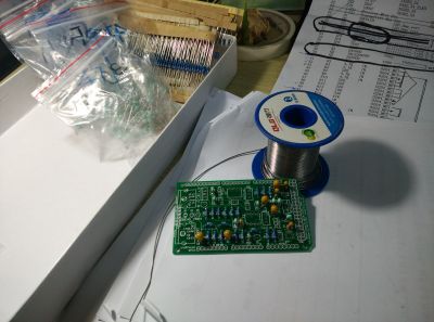

只看该作者 9楼 发表于: 2017-09-18
BG5HXE
浙江省杭州市
QQ:839525032

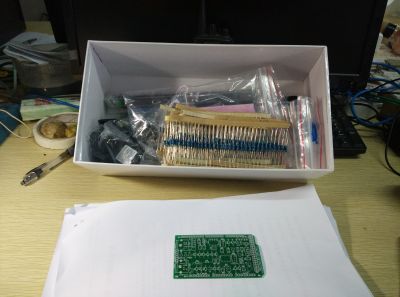

只看该作者 10楼 发表于: 2017-09-18
BG5HXE
浙江省杭州市
QQ:839525032

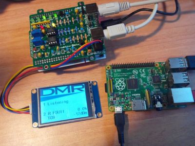

近日测试中,顺便测试了一下,收发DMR的短消息。确认DMR模式,除了转语音,短消息功能正常。
