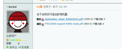

八重洲电台软扩频Destination_sheet_E00005035.pdf (1505 K) 下载次数:77
FT-891 软扩60米波段
1.Turn the transceiver OFF.
2.Press and hold in the [F] and [QMB] buttons while turning the transceiver ON.
   The green LED lndicator will blink with intervals of 0.5 sec (0.5 sec ON . 0.5 sec OFF).
3.Press the [F] button , and then the Green LED lndicator will blink with intervals of 1 sec (1 sec ON. 1 sec OFF).
4.Press and hold in the [F] button, and the radio will re-start automatically . Activation of the 5 MHz (60 m) band is successfully completed.
1、关闭收发器。
2、在收发器打开的同时按下并保持在[F]和[QMB]按钮中。
      绿色LED灯将以每0.5秒闪烁(0.5秒开,0.5秒关)。
3、按下[F]按钮,然后绿色LED灯将以1秒的间隔闪烁。(1秒开,1秒关)。
4、按下并按住[F]按钮,收音机将自动重新启动。成功地完成了5兆赫(60米)波段的激活。
我的891是红灯闪,按此方法未成功扩5MHz。各位试试,看能否成功,祝好运!
[ 此帖被莫森在2018-07-01 07:55重新编辑 ]
