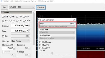

成功裝,但找不到Device?

generally speaking, when you see "no device", it means the driver of the device is not installed, or not installed properly.

Double click on install-rtlsdr.bat from within the extracted folder. This will start a command prompt that will download all the drivers required to make SDRSharp work with RTL-SDR. The command prompt will automatically close after a few seconds when it is done. It the bat file ran successfully the files rtlsdr.dll and zadig.exe will be downloaded into the SDR# directory. If they were not downloaded then your PC or anti virus solution may be misconfigured and may have trouble running batch files (Check that the folder is not read only, and not located in the Program Files directory).

目录里面确认一下,要存在rtlsdr.dll这样类似名字的dll

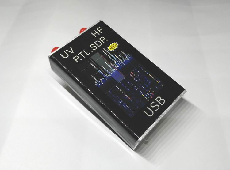

I bought this from BA5SBA工作室
I find that different version of SDR software show different device ? Why

板子照片有吗。脱光看看
