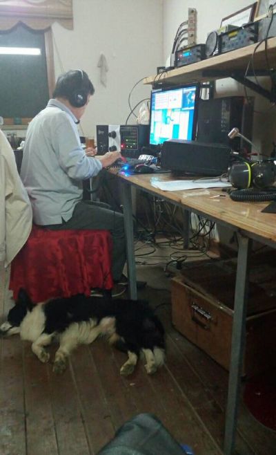

整个比赛陪着的是BH4SQE的牧羊犬.

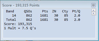

详细分析
CALLSIGN: BA4TB
CONTEST: CQ-WW-SSB
CATEGORY-OPERATOR: SINGLE-OP

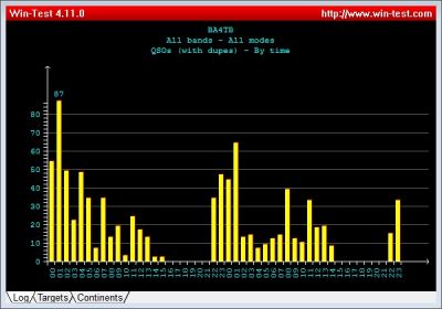

-------------- Q S O  R a t e   S u m m a r y ---------------------
Hour    160     80     40    20     15     10   Rate Total    Pct
0000      0      0      0    54      0      0    54     54    6.3
0100      0      0      0    86      0      0    86    140   16.2
0200      0      0      0    49      0      0    49    189   21.9
0300      0      0      0    22      0      0    22    211   24.5
0400      0      0      0    47      0      0    47    258   29.9
0500      0      0      0    34      0      0    34    292   33.9
0600      0      0      0     6      0      0     6    298   34.6
0700      0      0      0    34      0      0    34    332   38.5
0800      0      0      0    13      0      0    13    345   40.0
0900      0      0      0    19      0      0    19    364   42.2
1000      0      0      0     3      0      0     3    367   42.6
1100      0      0      0    23      0      0    23    390   45.2
1200      0      0      0    17      0      0    17    407   47.2
1300      0      0      0    13      0      0    13    420   48.7
1400      0      0      0     2      0      0     2    422   49.0
1500      0      0      0     2      0      0     2    424   49.2
1600      0      0      0     0      0      0     0    424   49.2
1700      0      0      0     0      0      0     0    424   49.2
1800      0      0      0     0      0      0     0    424   49.2
1900      0      0      0     0      0      0     0    424   49.2
2000      0      0      0     0      0      0     0    424   49.2
2100      0      0      0     0      0      0     0    424   49.2
2200      0      0      0    34      0      0    34    458   53.1
2300      0      0      0    46      0      0    46    504   58.5
0000      0      0      0    43      0      0    43    547   63.5
0100      0      0      0    63      0      0    63    610   70.8
0200      0      0      0    13      0      0    13    623   72.3
0300      0      0      0    14      0      0    14    637   73.9
0400      0      0      0     7      0      0     7    644   74.7
0500      0      0      0     9      0      0     9    653   75.8
0600      0      0      0    12      0      0    12    665   77.1
0700      0      0      0    13      0      0    13    678   78.7
0800      0      0      0    38      0      0    38    716   83.1
0900      0      0      0    11      0      0    11    727   84.3
1000      0      0     0     10      0     0     10    737  85.5
1100      0      0      0    33      0      0    33    770   89.3
1200      0      0      0    18      0      0    18    788   91.4
1300      0      0      0    19      0      0    19    807   93.6
1400      0      0      0     8      0      0     8    815   94.5
1500      0      0      0     0      0      0     0    815   94.5
1600      0      0      0     0      0      0     0    815   94.5
1700      0      0      0     0      0      0     0    815   94.5
1800      0      0      0     0      0      0     0    815   94.5
1900      0      0      0     0      0      0     0    815   94.5
2000      0      0      0     0      0      0     0    815   94.5
2100      0      0     0      0      0     0      0    815  94.5
2200      0      0      0    14      0      0    14    829   96.2
2300      0      0      0    33      0      0    33    862  100.0
Total     0      0      0   862      0      0   862
Gross QSOs=873       Dupes=11        Net QSOs=862
Unique callsigns worked = 862

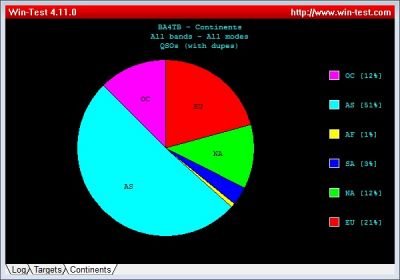

----------------- C o n t i n e n t   S u m m a r y -----------------
                160     80     40    20     15     10 Total    Pct
North America     0      0      0   102      0      0   102   11.8
South America     0      0      0    27      0      0    27    3.1
Europe            0      0      0   181      0      0   181   21.0
Asia              0      0      0   439      0      0   439   50.9
Africa            0      0      0     7      0      0     7    0.8
Oceania           0      0      0   106      0      0   106   12.3

ON              0      0      0     4      0      0     4    0.5
OZ              0      0      0     2      0      0     2    0.2
PA              0      0     0      2      0     0      2    0.2
PY              0      0      0    12      0      0    12    1.4
S5              0      0      0     3      0      0     3    0.3
SM              0      0      0     2      0      0     2    0.2
SP              0      0      0    10      0      0    10    1.2
SV              0      0      0     4      0      0     4    0.5
T32             0      0      0     1      0      0     1    0.1
T8              0      0      0     1      0      0     1    0.1
TA              0      0      0     3      0      0     3    0.3
UA              0      0      0    44      0      0    44    5.1
UA2             0      0      0     1      0      0     1    0.1
UA9             0      0      0    34      0      0    34    3.9
UK              0      0      0     1      0      0     1    0.1
UN              0      0      0     6      0      0     6    0.7
UR              0      0      0     7      0      0     7    0.8
V6               0     0      0      1     0      0      1   0.1
V8              0      0      0     2      0      0     2    0.2
VE              0      0      0     7      0      0     7    0.8
VK              0      0      0    35      0      0    35    4.1
VR              0      0      0     2      0      0     2    0.2
VU              0      0      0     4      0      0     4    0.5
XE              0      0      0     1      0      0     1    0.1
XW              0      0      0     1      0      0     1    0.1
XX9             0      0      0     1      0      0     1    0.1
YB              0      0      0    30      0      0    30    3.5
YL              0      0      0     2      0      0     2    0.2
YO              0      0     0      3      0     0      3    0.3
YU              0      0      0     5      0      0     5    0.6
Z3              0      0      0     1      0      0     1    0.1
ZL              0      0      0     7      0      0     7    0.8
ZL7             0      0      0     1      0      0     1    0.1
ZP              0      0      0     1      0      0     1    0.1
------------ M u l t i p l i e r   S u m m a r y ------------
Mult    160     80     40    20     15     10 Total    Pct
25        0      0      0   327      0      0   327   37.9
15        0      0      0    71      0      0    71    8.2
03        0      0      0    66      0      0    66    7.7
16        0      0      0    52      0      0    52    6.0
14        0      0      0    48      0      0    48    5.6
28        0      0      0    39      0      0    39    4.5
24        0      0      0    33      0      0    33    3.8
30        0      0      0    30      0      0    30    3.5
04        0      0      0    23      0      0    23    2.7
27        0      0      0    21      0      0    21    2.4
17        0      0      0    19      0      0    19    2.2
26        0      0      0    18      0      0    18    2.1
18        0      0      0    18      0      0    18    2.1
20        0      0      0    14      0      0    14    1.6
11        0      0      0    13      0      0    13    1.5
32        0      0      0    10      0      0    10    1.2
05        0      0      0     9      0      0     9    1.0
13         0     0      0      8     0      0      8   0.9
33        0      0      0     6      0      0     6    0.7
31        0      0      0     5      0      0     5    0.6
12        0      0      0     5      0      0     5    0.6
29         0     0      0      5     0      0      5   0.6
19        0      0      0     4      0      0     4    0.5
23        0      0      0     4      0      0     4    0.5
21        0      0      0     4      0      0     4    0.5
22         0      0     0      4      0     0      4    0.5
01        0      0      0     3      0      0     3    0.3
09        0      0      0     1      0      0     1    0.1
35        0      0      0     1      0      0     1    0.1
06        0      0     0      1      0     0      1    0.1
Multi-band QSOs
1 bands     862
2 bands       0
3 bands       0
4 bands       0
5 bands       0
6 bands       0
------- S i n g l e  B a n d   Q S O s ------
Band    160     80    40     20     15    10
QSOs      0      0     0    862      0     0
