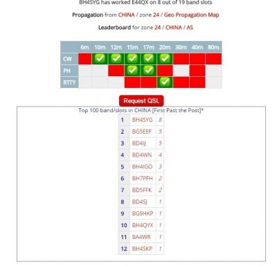

“Team E44QX will go QRT at around 03UTC on Sunday morning. Thanks to all the people around the world who met us in the Pile-Up’s!”
BH4SYG 再次领先BY!

疯狂的鲨鱼哥,没得比。
奇怪,E44并不是烂大街的货,这次国内台去追的却不多,难道就这么没吸引力?
