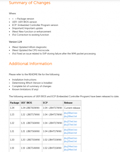

可悲的结局 T450s只有V1.19能正常关机,不知道联想以后会不会走出这个自以为解决问题的死胡同。
升级了V1.20和今天出的V1.21,还是没改变关机程式。
原本问题在于硬盘随着PowerManager Safe后,关闭了硬盘的供电以求节电效果,而恢复后能正常工作
但快速关机模式发生等好久不关机的问题。只要把PowerManager的硬盘 长久供电就解决的问题。
结果联想用固件去强行执行关机模式。照成快速关机模式的开机后,蓝牙以及声卡等DEVICE重新识别
而照成无法使用。
联想啊 你真的差劲 就这么个水准。 T450s就这么半终结了生命,也许再也得不到其他问题的固件升级,
只能强刷回 V1.19 固件 ......

联想花费了3个月零3天 今天的1.22版本终于走回正常路。
截至V1.19为止 ,v1.20,v1.21都是废品  先恭喜下联想
(BIOS ID: JBETxxWW)
<1.21>  正确的是<1.22>写错   <<-- 联想能不能认真严谨得做事 啊
- (New) Updated BIOS flash tool.
- (New) Modified UEFI PXE resolution.
- (New) Removed the intruder function to turn off when LID is open.
- (Fix) Fixed an issue related to system unable to power on due to chipset hang in some specific situation.
- (Fix) Fixed an issue related to screen resolution abnormal during UEFI PXE boot.
- (Fix) Fixed an issue related to SVP clear not working with SRsetupwin tool
<1.21>  (Drop)
<1.20>
- (New) Improved windows 7 32-bit OS available memory size.
- (New) Updated EDID table for new panel.
- (New) Updated Haswell C0/D0 MCU to 0000001Dh (M7240651_0000001D)
- (New) Updated Broadwell E0/F0 MCU to 00000022h (MC0306D4_00000022)
- (New) Supported multiple Legacy USB LAN Option ROMs.
- (New) Supported the Internal storage tamper detection.
- (Fix) Fixed an issue related to incorrect password behavior at unattended boot.
- (Fix) Fixed an issue related to BIOS flash failure with Intel PTT.
- (Fix) Fixed an issue related SMM stack leak in SmiFlashAllow.
<1.19>
- (New) Updated verbtable for noise.
- (New) Changed Haswell + N16s Tolud.
- (Fix) Fixed an issue that srsetupwin fails to install pop/hdp with clearing SVP.
- (Fix) Fixed an issue related to SCCM 80070490 error when HDP is set.
