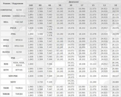

PSK31常用频点 [复制链接]
离线BG4IHP
1837
只看楼主 倒序阅读 0楼 发表于: 2016-01-26
1.838 MHz    160 meters
3.580 MHz    80 meters
7.035 MHz*    40 meters (region 3)
7.070 MHz*    40 meters (regions 1,2)
10.142 MHz    30 meters
14.070 MHz    20 meters
18.100 MHz    17 meters
21.080 MHz*    15 meters
24.920 MHz    12 meters
28.120 MHz    10 meters
50.290 MHz    6 meters

这个有人发过了,还有rtty

bd2fw:这个有人发过了,还有rtty (2016-01-26 20:32)
他发的不完整

15米21080是rtty ,psk31是21070

PSK31在7M(40米)及以下的低波段是用什么模式?LSB?还是USB?谢谢!

USB USB USB

对于PSK31来说,USB还是LSB对于通信没有影响,只是设置成LSB的话,显示频率要向上拨3kHz左右。
