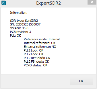

只看该作者 22楼 发表于: 2015-12-16
谢谢二爷和DRL,今天换了台机器,IP设成192.168.16.5,刷成了。改ip后,那个绿灯仍然是闪烁状态,并不像上面说的会变成常亮,我还是手动硬刷了。我想了一下,感觉完成这件事情两个原因都有,改这个特别的ip使在我这种情况能刷进去,换操作系统保证了刷机能刷完整。

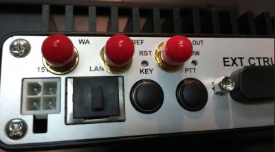

如果联不上,可以按下面的方法试试
Default address of the transceiver is 192.168.16.200. That is why to let PC and transceiver see each other, they have to be in the same sub-net (16).
Connect your SunSDR2 PRO directly (via LAN-cable) to PC.
Go to settings of Ethernet card (network) of your PC and follow the third article of this filehttp://eesdr.com/images/Document/SunSDR2_PRO/Getting%20Started%20SunSDR2%20PRO.pdf, set these numbers in IP address: 192.168.16.5.
While transceivers LED flashes periodically, the device is searching for network.
When LED will become static green, press search button in ExpertSDR2 options, you'll see pop-up menu found transceiver.
If you've done all that and you see no results, then set transceivers settings to default.
To do that, when your transceiver is on, press reset button on the rear panel of the transceiver, while pressing the button turn off and then turn on the transceiver.
Wait till LED will flash static green.

只看该作者 17楼 发表于: 2015-12-15
事情是这样的,原来没准备刷机,先下了这个同步软件,老的1.02版老用此功能是闪退,所以就想着是不是新版软件会好,果然新版软件上去同步软件可以连了。此时就开始按软件提示刷机了,走到大约五分之四的时候,报错,重试没有用,装回老的1.02版本提示刷机,到同一个进度时报错,关机重试,能找到sdr,但显示不能连接。复位也无效,再试新版也无效,现在就是可以search到sunsdr,但软件开关打开就报连不上sdr。

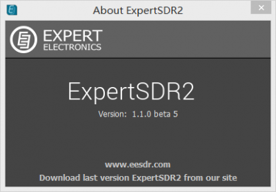

上当了,这是sunsdr2的,不是pro的,昨晚手贱,一刷机成砖头了

BG4DRL:ExpertSDR2 for SunSDR2 PRO v.1.1.0 beta 5
Microsoft Windows version.
http://sunsdr.eu/?smd_process_download=1&download_id=1361 (2015-12-14 17:03)
Posted on December 8, 2015 by SM0MDG
ExpertSDR2_SunSDR2_setup_1.1.0_beta5.exe
[ 此帖被BG4DRL在2015-12-14 17:39重新编辑 ]
