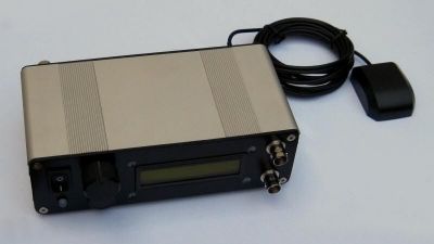

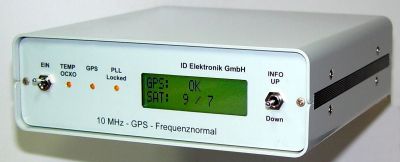

http://www.id-elektronik.de/
粮站看看这里有没有成品
山岭野兔
离线bg8bin
720
只看该作者 5楼 发表于: 2015-08-09
Prices:
GPS-Stabilized 10 MHz Oscillator (complete):€ 468,00
Active GPS-antenna with SMA-jack:€ 28,00
Plug-in AC Adapter 12V / 1A with 12V-Plug for Oscillator:€ 12,00
鬼佬真有钱啊

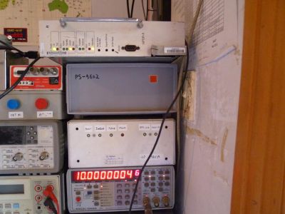

买个二手的GPSDO几百块就可以了。这是我用dz98那个230的板子改造的GPSDO。

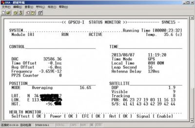

PC的监控界面。

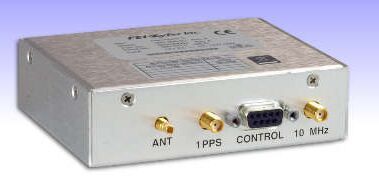

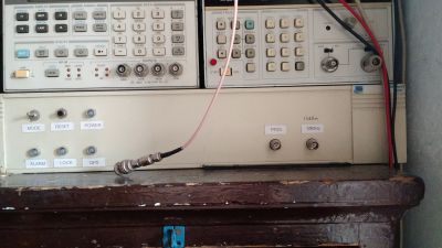

我的其它几只GPSDO,分别是HP的Z3801A, Z3815A和Trimble的ThunderBolt

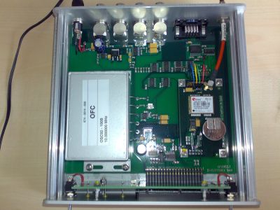

顶图的LCD GPSDO 拿到了一张 内部图 供参考
德国过来的报价如下
GPS-stabilized 10 MHz Oscillator complete     393,28 Euro without German VAT
Active GPS- Antenna with SMA-jack                 23,53 Euro   "            "        "
Plug-in AC Adapter 12V/1A                              10,08 Euro    "            "        "
Shipping cost to China                                     43,00 Euro    "           "         "
also complete                                                469,89 Euro
Our terms of payment are "cash with order"  with bank transfer.
