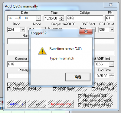

更换SSD以后重装系统 重装所有软件 LOGGER32一直用着没有问题
结果今天手动添加qso无法完成 强制退出……具体表现如下
上图Q1Q 呼号为测试呼号
提示为:Run time error 13 Type Mismatch
官网提示的解决方案1:
1.4 "Run time error 13 Type Mismatch": This error is usually brought about by an error in the LOGBOOK file. Open up a NEW logbook ([url=http://www.logger32.net/help/Logger32/main%20menu.htm#file menu item]File -> Change Logbook[/url]) and retry the function you were doing when the error occurred. If you do not receive the run time error 13, then something is corrupt in your logbook. Close Logger32 and replace the four logbook files from your last backup � or - delete the four logbook files, restart Logger32, create a new logbook file and import your recent ADIF backup file. You did do a backup recently right?
官网提示的解决方案2:
5.1 I receive a "Runtime Error 13 - type mismatch": This error is usually associated with an error in the Logbook data. To correct the problem, try thr following:
1. Backup your original logbook files (there are four) and they are in the Logger32 directory, named mylog.isd, isf, .isl and .ism.
2. Start Logger32.
3. Export your entire logbook  in .ADI format.
4. Close Logger32.
5. Delete the four logbook files mentioned above.
6. Start Logger32 and Import the exported .ADI file saved in step 3.
两种方案全部试过 但是还是不行 再次重新启动以后手动添加呼号 还是 Run time error 13 Type Mismatch……
决定完全备份以后重装LOGGER32
结果安装的过程中出现下图……
全部点击YES勉强安装完成
可是进入LOGGER32以后还是无法手动添加qso……
找了另外一台笔记本电脑 安装Logger32 Full v3.50.0 并且自动升级到最新版本 安装过程中没有出现version conflict……手动添加qso成功……现在不知道问题出在哪里了
继续琢磨中

搞大发了 正在重装电脑 幸好日志没事。。。。

最新进展 把三个文件删除以后 再次安装 结果还是一样。。。用360扫了一下 系统修复 得 win7直接挂了。。。
重装win7以后OK了。。。
