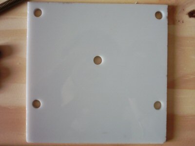

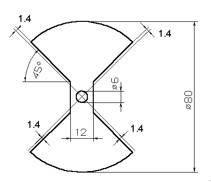

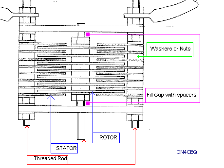

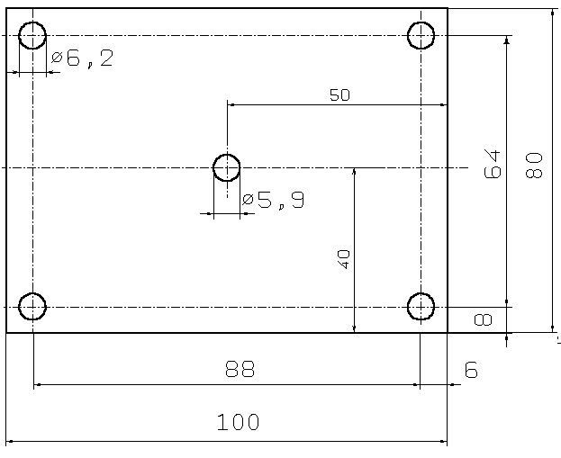

How to build your own Butterfly Capacitor.

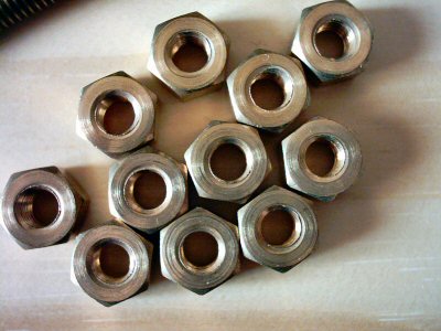

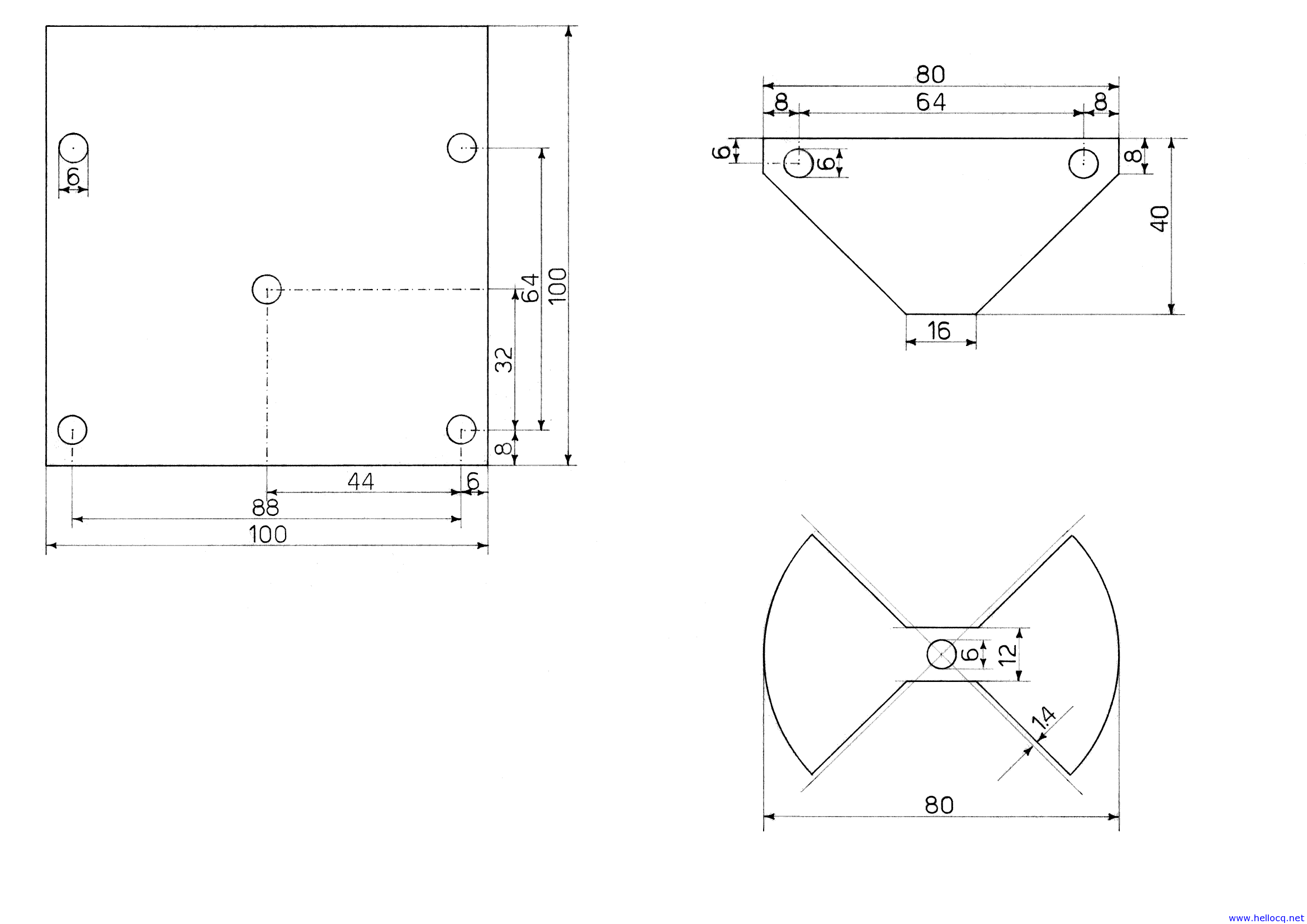

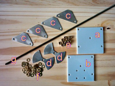

The best material for the front and the back is CLEAR PVC 3 or 5 mm thick as alternative you can use GREY PVC or 2 sheets pcboard together with the copper removed .

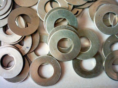

The best material for the washers, nuts (M6) and threaded rod (M6) is brass or stainless steel,( NON MAGNETIC MATERIALS for the losses).

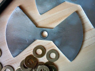

For the spacing of the vanes you can use 2 washers M6= ( 6Kv) or a nut M6 =( 12 Kv) if you use aluminum plate 1 mm thick.
If you use a nut then the best thing to do is remove the thread by drilling withØ 6.2 mm.
The effective area for the vanes is 11.7 cm² and with the formula
for 2 washers = (0.0885 x 11.7 cm²)/ 0.1 cm = 10.35 pF for 1 air gap.
for 1 nut = (0.0885 x 11.7 cm²)/0.2 cm = 5.17 pF for 1 air gap

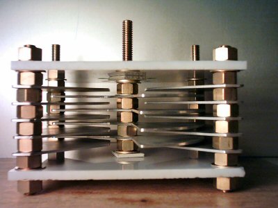

Example:
If you you make a capacitor with 2 washers as spacing and you make
5 rotor vanes and 6 stator vanes then you have 10 air gaps.
10.35 pF x 10 = 103 pF + 10 pF stray capacitance = 113 pF / 2 = 56 pF
The final result is a capacitor with a value from 5 - 56 pF.

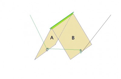

其实我看见国外很多人DIY高耐压电容制作LOOP时,最简单的方法就是:自制'合页电容"
用两块像B5大小的铜片或者铝片,一端以合页形式固定,另外一端用绝缘丝杠调整“大合页”的开启角度,从而实现电容的调整。当然电容大小不同,两片铜箔的面积也应当有所不同。虽然这种方式非常简易,但保证100瓦没有问题,制作起来一定能够成功。在没有绝缘塑料丝杠可用的情况下,还发现更简单的丝线固定方法,靠丝线固定电容开合角度,电容每个极板两端有固定丝线(极板上每边套一圈),滑动调整,不然电容工作会很不稳定。附简易示意图:

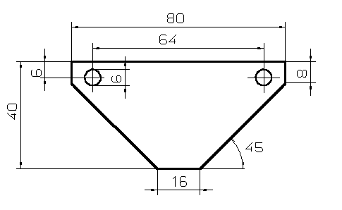

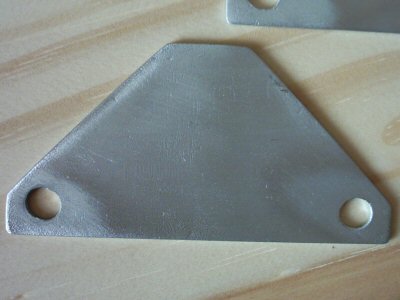

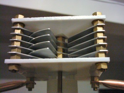

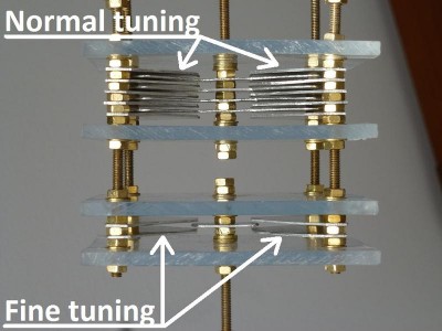

另外一种蝶形电容的自制.
I think I could use it up to 300-500 Watts(承受3、5百瓦没有问题)
BD2BH_SHE@163.COM
离线bd2bh
2584
只看该作者 4楼 发表于: 2014-10-10
I think I could use it up to 300-500 Watts(承受3、5百瓦没有问题)[attachment=656228]
