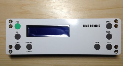

The forced restore defaults page in this menu has been eliminated, as this very rarely used function is already available from the front-panel. If you ever have need to restore the defaults, then, from the power off state, press and hold the BAND+ button, and power up the transceiver. Continue to hold the button until the Reset Defaults prompt appears. Release the button, and briefly press the BAND+ button to restore the defaults, or the PWR button to cancel the operation.
Modified User Configuration Menu Prompt
Previously, when entering the User Configuration menu, the last selected menu page would be immediately displayed. In this version, to enter the User Configuration menu, press and hold the DISPLAY/CONFIG button. After the second function timer has expired you will receive a prompt: 'User Configuration' that will be displayed as long as the DISPLAY/CONFIG button is held. Release the button, and the last selected configuration page will be displayed. Select pages with a brief press of the DISPLAY/CONFIG button, edit the values with the UP/DOWN buttons, press and hold the DISPLAY/CONFIG button to rapidly select a menu page. To exit, briefly press the OPER button and respond to the prompt.

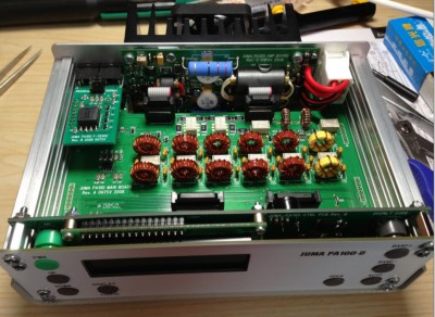

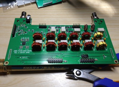

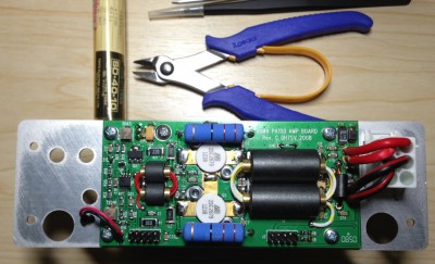

前年底用光亮焊了台漂亮的100D
