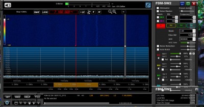

The New ELAD FDM-S2
Direct sampling receiver based on 122.88MHz 16bit single channel ADC converter covering HF 6m and offering the possbility to exploiting the undersamplig mode covering FM Broadcasting Band and exploring part of VHF Band (135-160)MHz.
Ranges & most important specs:
    HF: 9kHz-52MHz MDS: -132dBm @14MHz, Clipping lev -8dBm
     FM: 74-108MHz sensitivity <2uV 12dB SINAD @98MHz, Clip lev -3dBm
     VHF: 135-160MHz MDS -137dBm @145MHz, Clipping level -19dBm
Separate antenna inputs for HF/6m and FM/VHF/Bypass ranges
Max. DDC Bw 6144kHz (Aliasing free viewable bandwidth up to 5 Megahertz)
    currently available selectable bitstreams:
     192ksps-32bit, 384ksps-32bit, 768ksps-32bit, 1536ksps-32bit, 3072ksps-32bit, 6144ksps-16bit
Special double DDC mode of 2 x 384kHz bandwidth to be placed within one of the input ranges.
    4 virtual receivers freely tunable within DDC window
     Each virtual receiver holds settings for mode,bandwidth,volume,squelch and audio output routing.
Patent pending Triple Tuning Bar for coarse and fine spectrum navigation
CWU,CWL,USB,LSB,AM,SAM,FM,WFM,DSB,RTTY,DRM,RDS modes
Interference rejection: Noise Blanker,Adaptive Noise Reduction and auto notch,
special 2 manual notches (directly placed in DDC spectrum)
Integrated DRM decoding, text and station schedule update.
Integrated WFM Stereo with RDS decoding.
Universal CAT control and  OmniRig(tm) integration
Customizable IF panadapter facilities for integration with existing transceiver/receivers
User definable bandplan, specified settings per frequency range.
XML based memory management
DX cluster data integration and EIBI database import
Plotting of memory, database and cluster information directly on spectrum screen
Proprietary Ext IO bus for accessory equipment, also offering 8 DC lines for universal switching (*via SFE1.0 board)
Supported by 3rd party software: SDR-RadioV2 , Winrad, HDSDR, Studio 1
DDC Spectrum recorder with automated timeschedule control
Seperate IF/AF spectrum windows for detailed signal analysis
Easy, fully informative User Interface with deep customization
Resizable windows and multi-monitor support
Wideband secondary Audio/IF outputs for decoder software (eg CW Skimmer,WeatherFax)
Full integration of the Tmate and Tmate2 series controllers
Compact size 110 (W) x 90 (D) x 40 (H) mm and 360g, come with 2 BNC to SMA adapters, USB cable, USB double cable adapter, CD and safe bag.

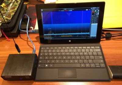

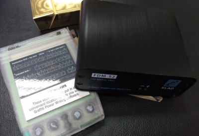

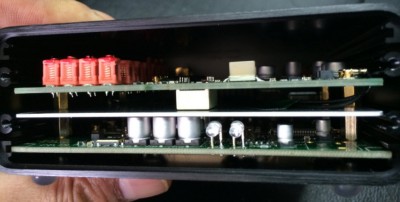

非常小巧 但有份量
包装内容
前面面孔
后面配转接口
続く…

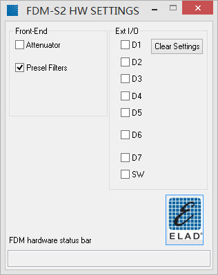

只看该作者 1楼 发表于: 2014-04-03

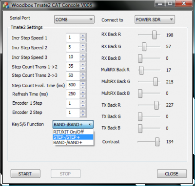

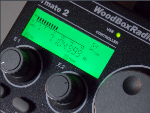

COM口试 HID方式识别 非常喜欢
也不会因为插拔后改变COM口号码  设计得很周到合理
屏幕颜色RGB拼色也通过 驱动调整,FunctionKey设计很独到

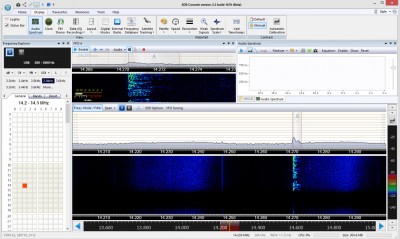

只看该作者 5楼 发表于: 2014-04-03

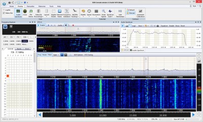

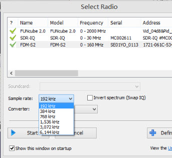

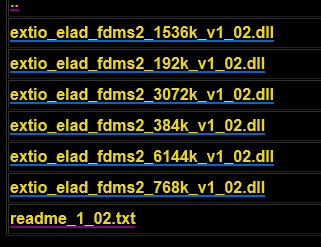

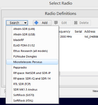

外部3rd软件
-HDSDR有待研究 ExtDLL加载如上
-V2 SDR-Radio版本支持S1和S2
采样率
FCD Plus=384Khz
SDR-IQ=190Khz
FDM-S2高达6144Khz,同时两路启用 就是厂商所称谓的122.88Mhz采样率
实际效果不错,机器有点微热 感觉是45度左右
[ 此帖被BG4DRL在2014-04-04 00:51重新编辑 ]

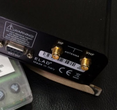

***AGC状态不稳定问题找到
HF接口:
金BNC转SMA转接头 原来是5块钱的某宝粗制品 接触性能不良,更换20cm BNC to SMA转接线 问题解决
VHF接口:
直接用SMA一条线 头剥皮 ,或者直接用SMA接头的短弯 拉杆天线接收VHF  这个已经足也现实点

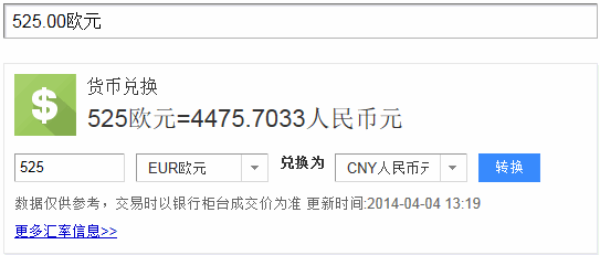

1????块就是这样被花掉滴。
邮箱:BG0APD@163.com
电话:15309910960
离线BG0APD
8463
只看该作者 9楼 发表于: 2014-04-04
回 BG0APD 的帖子
BG0APD:
1????块就是这样被花掉滴。[表情] [表情]
看了看,不算贵。

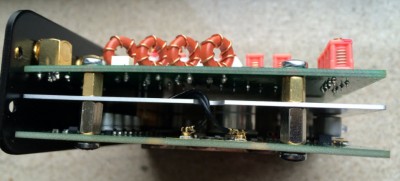

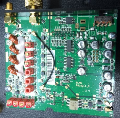

金接口  HF / VHF 已经分开。
这个VNA HF Converter的性能表现得 非常满意
ELAD-IT 一丝不苟 不妥协的做法  非常好
[ 此帖被BG4DRL在2014-04-06 13:56重新编辑 ]

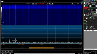

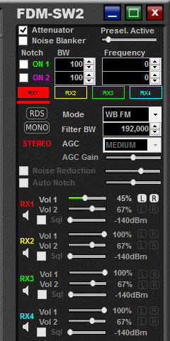

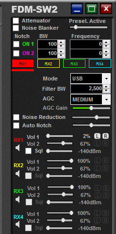

只看该作者 17楼 发表于: 2014-04-04
采样带宽内 四路同时接收
再次体会了下no ATT状态,
原机性能调升的非常完美,特别是HF状态与VHF的分离,
为避免ADC Over 这个ATT衰减很有必要。
Preselect也做得相当可以。足以应付各种折腾,也希望SW2软件再次大幅度关注和改良
[ 此帖被BG4DRL在2014-04-06 14:01重新编辑 ]
