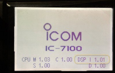

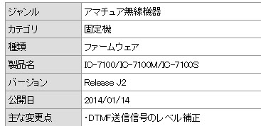

Improvement
The DSP firmware update corrects the IC-7100's DTMF tone level.
•A mini-B type USB cable is required.
•You must install the USB driver before connecting the USB cable between the IC-7100 and the PC. Download the USB driver here.
•Thoroughly read "Firmware update instructions (here)" to know what the update requires.
•Save the transceiver's data onto an SD card or to your PC using the CS-7100 cloning software. It is possible that your data could get lost during the update.
•Never turn OFF the transceiver power or disconnect the USB cable during the update.
•The firmware updates DSP I version 1.00 to version 1.01.

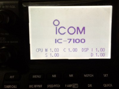

声卡驱动,com驱动两个安装完毕后
固件升级模式:
中指压住AutoTune和XFC
食指压住DR
左手按电源后,接收等闪烁1s间隔Blink
启动软件直接刷机
刷机前
刷机后
