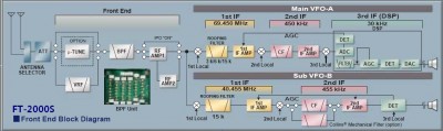

经过这次CQWW比赛,觉得FT-2000D的VRF挺好用的啊!

只看该作者 1楼 发表于: 2013-11-07
The FT-2000D receiver front-end includes VRF (Variable RF Tuning) preselector which works in conjunction with a bank of fixed bandpass filters. This provides a front-line defense against strong out of band signals. The result is improved dynamic range and a higher intercept point than other designs.

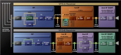

只看该作者 4楼 发表于: 2013-11-07
The u-Tuning Kit that was developed for the FT DX 9000, is optionally available for use with the FT DX 3000

只看该作者 5楼 发表于: 2013-11-07
FTDX-3000
