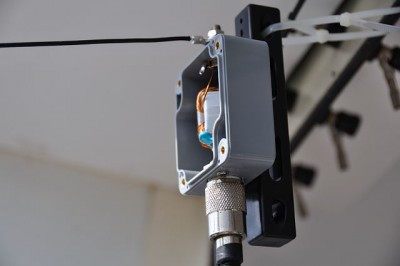

5波段的不错,不用天调了,振子还相对短,端馈的架设方便。

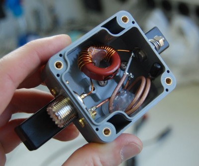

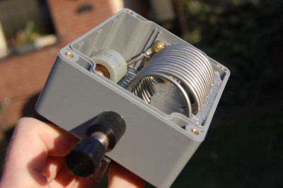

想知道盒子里的结构图
离线bd4igh
4250
只看该作者 27楼 发表于: 2013-09-10
盒子里是什么东西?

还是没有看清楚,能否再近点,平且给与指点,想试试这个天线
离线胡线电
1642
只看该作者 30楼 发表于: 2013-09-17
是同轴电缆的尾部空着,把同轴电缆当一电容??

那个电感数据不知是多少。

上个盒子里东东的接线图看看?谢谢!

还有磁环的规格?

半波天线,盒子是阻抗匹配,也可叫升压器。天线电压高得很

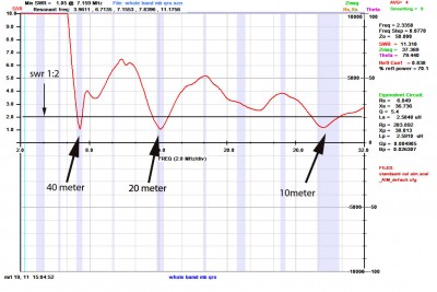

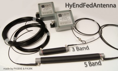

Great Antenna - Better Than Expected   Time owned: 0 to 3 months
Recently installed a 4 band antenna as a not-so-flat flatop at around 10m high each end and about 11m high in the middle. Feeding with 20m of RG58U.
It works as advertised - well better in my opinion. According to my rigs SWR meter (and closely followed by an MFJ analyser) the VSWR I get are as follows:
40M: 7.045 = 1:1, 7.2 = 1.4:1
20M: 14.15 = 1:1, 14.345 = 1:1
15M: 21.15 = 1.4, 21.45 = 1:1
10M: 28.31 = 1.3:1, 29.1 = 1:1
Curiously 17M and 12M are 1.9:1 anywhere. 80m is >3.0:1 as expected, but tunes up easily enough and works ok.
So far have worked a handful of DX and get good reports. It is a fairly quiet antenna. Mounting was straight forward and the strain relief is a good idea. One thing to note is that it is very light weight (but robust), so much so that it does not cause my 9M fiberglass telescopic mast to bend under the weight. Nice.
Dealing with Rob (pa3eke) was a pleasure and he kept me very informed along the way. My antenna appeared to be made to order which was nice. Shipping from EU to AU took a few weeks, but worth the wait.
You won't be disappointed with this antenna and I am considering getting another to place at 90 degrees to my current one for some added directivity.
