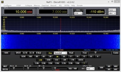

NaP3 RX I/Q 192khz ASIO EMU-0204,Roland UA-55,Konnekt Live 比较 [复制链接]

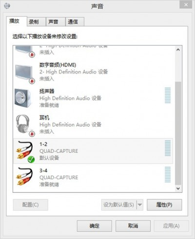

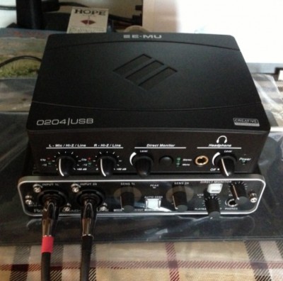

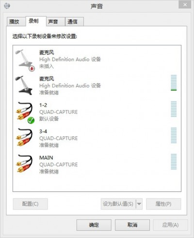

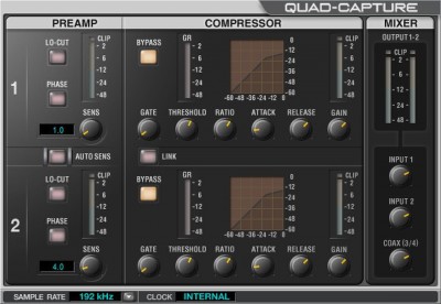

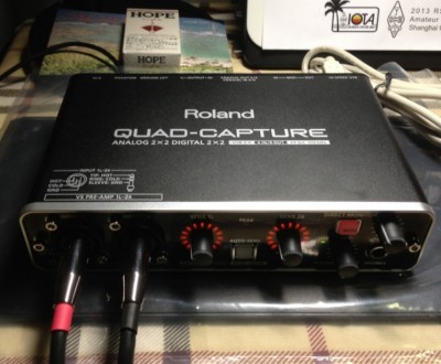

只看楼主 倒序阅读 0楼 发表于: 2013-08-09
入手Roland UA-55 ,Win864的ASIO驱动,用Foobar2k独占输出

我用的是外置版本的0404驱动还是有的。

您还是卖了换新的吧 这个达到-144db  老产品该换换了

Roland UA-55
Frequency Response
192.0 kHz 20 Hz to 90 kHz (+0/-8 dB)
20 Hz to 60 kHz (+0/-2 dB)
96.0 kHz 20 Hz to 40 kHz (+0/-2 dB)
48.0 kHz 20 Hz to 22 kHz (+0/-2 dB)
44.1 kHz 20 Hz to 20 kHz (+0/-2 dB)
Dynamic Range
AD block INPUT 1, 2: 104 dB typ. (GAIN: min.)
DA block OUTPUT 1, 2: 109 dB typ.

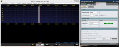

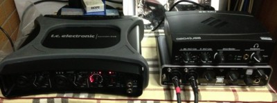

只看该作者 11楼 发表于: 2013-08-20
完美背噪
与TC Electronic Konnekt Live 并列排名了
Roland还是不赖的  88Pro还好55mkII也好 都是名器

只看该作者 12楼 发表于: 2013-08-20
模拟口给它肯定到不了-144db呀,话筒放大器的等效噪声都-120了

只能说一分价格一分货,EMU0204 排名最下等

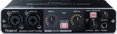

只看该作者 16楼 发表于: 2013-10-31
Re:NaP3 RX I/Q 192khz ASIO
QUAD-CAPTURE Driver Ver.1.5.2 for Windows 8.1 / 8 / 7 / Vista / XP
This is the QUAD-CAPTURE driver for Microsoft Windows 8.1 / 8 / 7 / Vista / XP.
Products:QUAD-CAPTURE
* Uninstall the old driver before you install the new driver. For details on the uninstallation procedure, refer to the Readme.htm file that was created when you extracted the archive.
* Since audio buffer settings are initialized after updating the driver, please setup the audio buffer settings in the driver again.
Update history
[ Ver.1.5.2 ]
•Now available for Microsoft(R) Windows(R) 8.1.
•Changed the item name "Reduce CPU load" in the Settings dialog box to "Low Latency mode."
This reduces the load on the CPU when the ASIO buffer size is small, and then it lowers the latency of the ASIO driver.
* If you cannot play back or record or if the sound is interrupted, clear this check box.
* If you're using in WDM/KS mode, clear this check box.
