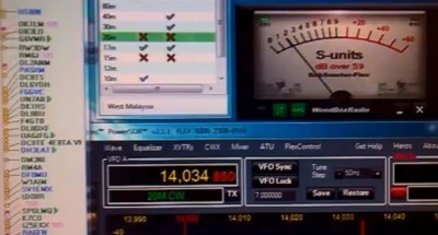

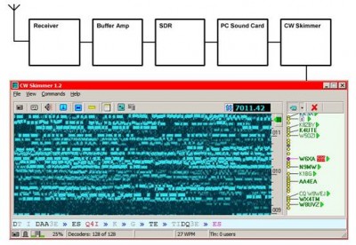

土办法 杀鸡取软的可以用这样的办法 采样要宽
BG4DRL
UID:360404
2011-07-07
2023-05-15
8155小时
发表于: 2013-08-06
Radio type: SoftRock-IQ
Sampling: 96 Khz
CW Pitch: 600 Hz
Audio IF: 9600 Hz
Audio---> Channels:Left/Rigth: Q/I NOT I/Q
