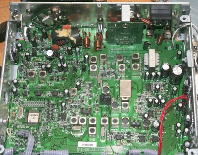

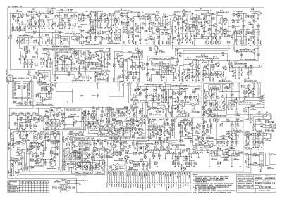

Tx Rx都没有.手册 test point 和實物也有出入.求高人指教,由那开始.

多谢大家提供线索, Weed 師兄, 机内石英有三个:10.6975;
10M07;
10.2417;
打算用IBQ的小counter测一下附近有什么信号...
找不到大師'惟有先動手探看病情;请大家相助一下思路,
CPU旁有个849-7HU;
service menu 内的线圈名稱位置是对的,但TP不同什至不见了.悲催啊.

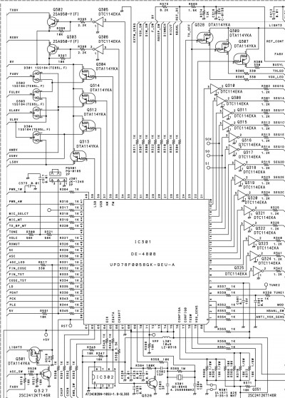

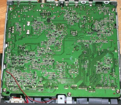

ok,拿IBQ向各石英附近下手, 测得各部附近都有信号及电压,除石英X271(10.6975MHz)外;先檢查供电, 5V, 8v穩压IC供电正常.
再看线路, FA8V 一组, US8V一组,LS8V一组共分三组上电去X271,发现打去FM,AM mode时, FA8V只有7V供电, 打去USB或LSB mode时, US8V, LS8V都有近8V电压,而X271亦有信号及电压了. 即是在AM/FM时, FA8V供电不正常.
FA8V由 D301(1ss184)及 Q304 (DTA114YKA) 经cpu控制...
继续检查供电: (F:Fm; A:AM; U:usb; L:Lsb)例如FA8V,即是说mode打去FM,AM时,此位置都要有8V电压,结果如下:
FA8V>D301>FM~7.06V,AM~7.04V;
FUL8V>D302>FM~7.2V,USB~6.49V,LSB~6.49V;
ULA>D303>AM~7.17V,USB~6.49V,LSB~6.49V;
UL8V>D304>USB~7.17V,USB~7.11V;
AM8V有7.8V;
似乎前四个都工作电压低了.是1SS184的问题还是相关DTA114的问题?不熟它们的性能,请教大家了.
另外再发现经CPU控制 TX8V输出的Q305(DTC114EKA),脚3在Tx时不能维持高电位, PTT出一下就降回0V, Q305是控制Q302(2SA950), 使输出Tx8V,现在失效,希望是Q302和Q305的问题, 大家说Q305定CPU可能性大呢? DTC114EKA易找吗?

断开测CPU脚 34, 结果 保持:按PTT,此脚不能出正常高电位...还有救吗? CPU脚23(Tx-off)关 舍?
UPD78F0058GK-9EU-A怎辨?
整理一下问题:先弄接收
有部份电压看来低了,就是那几个开关管问题? 舍易坏呢? 此部份CPU估计工作正常.

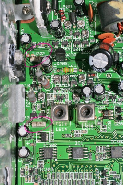

回楼主,我也买了一台这样的机器,一样是不能接受和发射。
在没有仪器的情况下,按着发射键,反时针旋转L402的磁芯,看到TX指示灯亮了就行了(1信道和40信道都测)。这时候功率也起来了,接收也正常了。VCO也就锁定了。

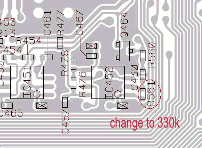

President Jackson 2 Modulation modification.
After this modification your Jackson 2 has a super modulation audio on FM/AM and SSB with the original microphone! The original microphone is very good.
You only have to chance 3 parts on the main unit and remove 2 caps behind the mic. Jack.

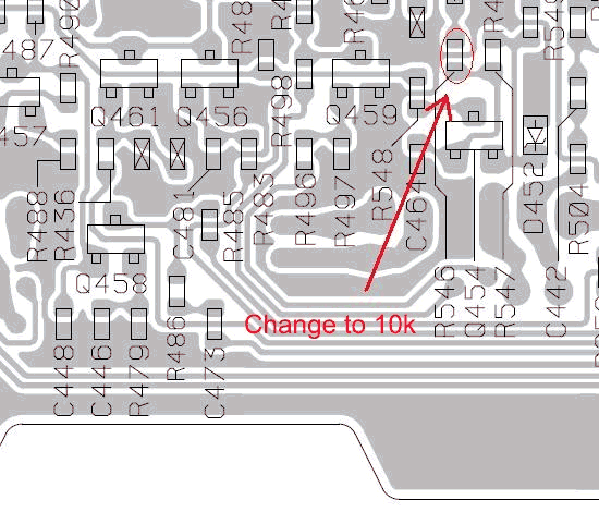

Change R 561 from original 33k to 330k
This will power up the mic. gain.

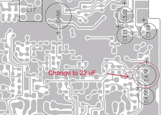

Change C 472 from original 220 uF to 22 uF
This will shorten the limiter time.
Change R 546 from original 2,2k to 10k.
his resistor is on the lower side from the main unit. This will raise the limitation point

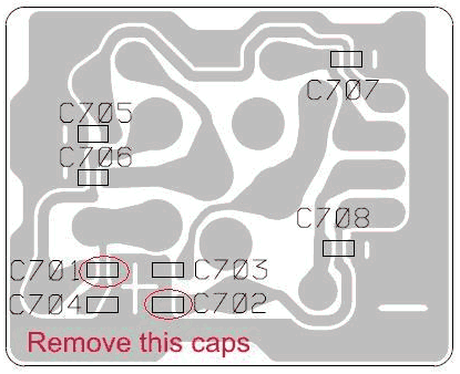

Remove cap. C 701 / C 702.
This caps are behind the mic. jack, this will raise the high tones from your modulation.
After you have made this modification you have to readjust the Pot. RT 203 and RT 452 for AM and RT 451 for FM.
Now have fun with your modified President Jackson 2 and the original Microphone
This Mod From DL5KH

按你的意见动了L402,果然起振了, FM SSB AM接收有了, FM, SSB发射都有了, 但AM发射有功率但调制有问题,声音出不了(PTT时一瞬间出声音接着没了),但有功率.
AM, FM功率低,1.5W上下, SSB有十多W.
初步试了几个地区模式,结果差不多.
另请教一下,为什么L402会影响CPU?
