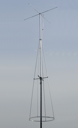

Wide Band Base station antenna
Omnidirectional
High power handling capability
Made of aluminium alloy 6063 T-832
Electrical Data
Type: 1/4 λ Ground plane
Frequency range: 26.5-28.5 MHz @ SWR ≤ 1.5
Impedance: 50Ω
Radiation (H-plane): 360° omnidirectional
Polarization: vertical
Gain: 0 dBd, 2.15 dBi
Max. power:
1000 Watts (CW) continuous
3000 Watts (CW) short time
Feed system / position: Gamma match / base
Connector: UHF-female
Mechanical Data
Materials: Aluminium, Steel, Nylon
Wind load / resistance: 242 N @ 150 Km/h / 130 Km/h
Wind surface: 0.21 m²
Height (approx.): 3640 mm
Weight (approx.): 3900 gr
Mounting mast: Ø 35-42 mm
附有安装图
