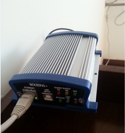

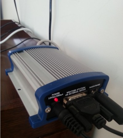

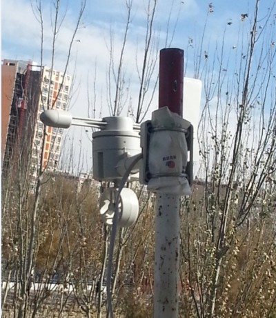

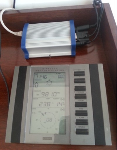

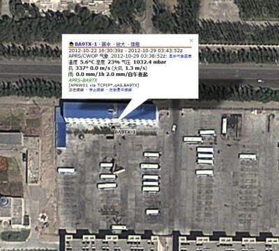

安装完毕  上图

这一套不错

改天把车台接上
价格:180刀+1200人民币

挺好的,那个180刀的支持PEET BROS格式吗?
73 de BD6CR/4 上海浦东
离线BG9TX
3066
只看该作者 7楼 发表于: 2012-10-29
回 BD6CR 的帖子
BD6CR:挺好的,那个180刀的支持PEET BROS格式吗? (2012-10-29 16:57)
这个格式不了解

http://microsat.com.pl/product_info.php?cPath=21&products_id=34
Weather station server
WX3in1 allows you to receive weather information from weather stations via the RS-232 cable. The data is then encoded into the APRS frame and may be sent to a radio network at specified intervals. Additionally WX3in1 Plus allows you to send the same frames to APRS-IS server.
Supported weather stations:
- LaCrosse/Technoline WS-2300,
- LaCrosse/Technoline WS-2350,
- Peet Bros Ultimeter 100,
- Peet Bros Ultimeter 800,
- Peet Bros Ultimeter 2000,
- Peet Bros Ultimeter 2100,
- Davis Vantage Pro (with RS232 datalogger),
- Davis Vantage Pro2 (with RS232 datalogger),
- Davis Vantage Pro Plus (with RS232 datalogger),
- Davis Vantage Pro2 Plus (with RS232 datalogger),

谢谢,看起来ADS-WS1气象站也能被支持。

Lacrosse2300直接配6CR的OT2M多好,成本低很多啊。

现在是OT3m了,记得连在串口PORTB上。

只看该作者 12楼 发表于: 2013-02-19
回 BD6CR 的帖子
BD6CR:现在是OT3m了,记得连在串口PORTB上。 (2012-11-02 13:49)
WS1气象站的pin10和11接OT3M串口的7和8?
