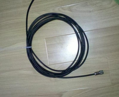

为了参加周末的MULANDXC,参照@bd2bh老师的帖子,在阳台外面挂了个CG3000,两根22.5米的电线呈倒V状斜拉出去,扣在楼下的树上,
因为馈线长度不够,所以没有绕balun,直接在馈线根部扣了5-6个磁环,但是在有些频率比如3.850调谐会有RFI,耳机里面有声音,而且usb-com口
会受到影响,导致电脑蓝屏,后来翻了根长的馈线出来,准备绕个Choke balun,看网上帖子说圈数无所谓,总厂16-20 feet就行了,
现在问题是,一定要绕成这种一圈一圈相邻的结构吗?
我这样随便绕的行不行?
家里没有PVC水管,如果一定要绕成上图那样的,我看了看,只有绕在电饭锅内胆或者小垃圾桶上,然后用尼龙扎丝扣起来了。。。

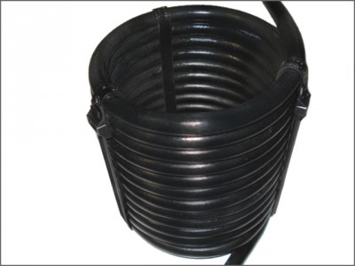

看这个链接上,也有像我这样绕的。。。
http://www.qsl.net/ta1dx/amator/broadband_baluns.htm
离线BH4SKP
13227
只看该作者 2楼 发表于: 2012-04-20
The required length of the plastic pipe depends on the diameter and length of the coax used and the diameter of the pipe. For RG-213/U coax, about one foot of 5 inch size pipe is needed for a 1.8MHz to 30MHz balun. For 3.5MHz to 30MHz coverage, about 18 to 21 feet of coax is needed. This length of coax is also adequate for most applications on 1.8MHz.
18 to 21 feet should cover all of 160 through 10 meters.
The number of turns is not critical because the inductance depends more on the length of the wire (coax) than on the number of turns, which will vary depending on the diameter of the plastic pipe that is used.
The coax is single-layer close-wound on the plastic pipe.
The first and last turns of the coax are secured to the plastic pipe with nylon cable ties passed through small holes drilled in the plastic pipe.
The coil winding must not be placed against a conductor.
The name of this simple but effective device is a choke-balun.
NOTE: Some people build choke-baluns, without a plastic coil-form, by scramble-winding the coax into a coil and taping it together. The problem with scramble-winding is that the first and last turns of the coax may touch each other. This creates two complications. The distributed-capacitance of the balun is increased and the RF-lossy vinyl jacket of the coax is subjected to a high RF-voltage. The single-layer winding on the plastic coil-form construction method solves these problems since it divides the RF-voltage and capacitance evenly across each turn of the balun"....AG6K

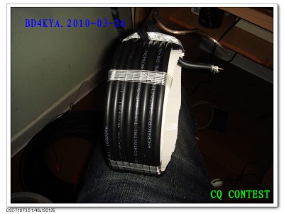

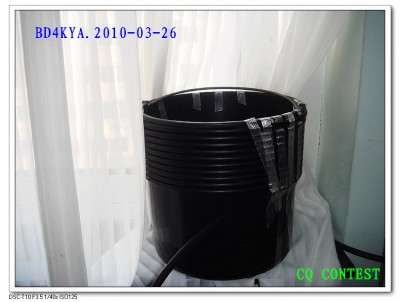

想绕圈还不简单,有次野外忘拿巴伦,用2双一次性筷子和鱼线绕个扼流圈一样,在家里只有看有什么用什么了。
1.比赛时,临时用垃圾筒内胆绕个放自己窗台上。
2.在小区院子拾个PVC水管,很窄的,也可以绕。
3.我分析你的CG3000天调干扰其中最大问题是你把它放在你电台近处,依我看你把天调远离你电台室隔壁一个窗外就好了,我以前有过你的这样经历。
引用BA7IA老师一段扼流圈文章抑制法,振子经过一高频扼流圈接电缆屏蔽层外皮,阻止高频电流流向电缆屏蔽层外皮,此法比较简单,就是把电缆绕十圈左右,绕在磁环上更好,空心也没关系,一般是频率低绕多几圈,频率高小绕几圈。但抑制效果没有前述几种好,因此前面几种多用于专业应用,这种业余应用较多。要记住的是我们只是截断屏蔽层外皮的高频电流,并不是截断流向屏蔽层的所有高频电流(要这样的话把振子和电缆皮断开就得了),高频电流是在屏蔽层的里面流的。形象一点可以把电缆想象成水管,本来应该是水都在水管里流,如不加巴伦,水不单在水管里流,而且有一部分还流到管子的外皮。巴伦的作用就是防止跑、冒、滴、漏,迫使水都在水管里流,难言之隐,一用了之!

只看该作者 7楼 发表于: 2012-04-23
回 BH4SKP 的帖子
BH4SKP:谢谢4KYA~~晚上回家搞一个试试看效果~~
 (2012-04-20 16:49)
要并排绕,乱了不好~~~
