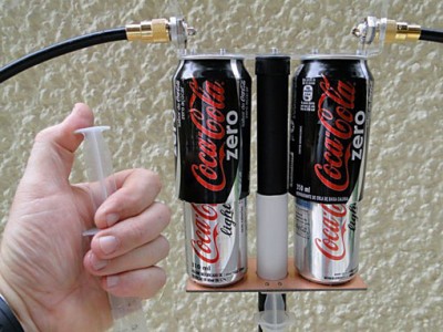

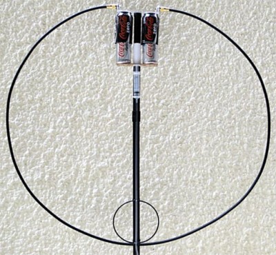

可口可乐循环是一个小的磁环形天线调谐的长号风格可变电容器用标准的苏打罐。
In Brazil we have the Coca Zero and the Coca Light versions of Coke. 在巴西,我们有可口零和可口可乐的光版本。The Coca-Cola Zero can is shorter and wider and the Coca-Cola Light can is longer and thinner.可口可乐零可以是短而宽和可口可乐光可以更长和更薄。
这个循环结束连接到固定可口零(更大的)罐。The moving trombone variable capacitor portion is made with Coca-Cola Light cans screwed to a piece of double-sided PC board.移动长号可变电容器部分是由光与可口可乐罐固定在一块双面印刷电路板。
The PC board is also screwed to the moving part of an injection syringe that is connected to another injection syringe by a plastic flexible tube filled with water. PC板也用螺丝固定在移动的部分注入连接到另一个注射器注射注射器塑料软管注满水。This makes a hydraulic remote tuning system to adjust the antenna resonance point.这使得一个液压遥控调优系统调整天线谐振点。
The loop is made with a section of 112 inches of standard coaxial cable with PL-259 connectors on the ends that attach to the tuning system unit.循环是由一段112英寸的标准同轴电缆与pl - 259连接器在末端附着在调优系统单元。
The excited loop is made from a 22.4-inch section of solid electric copper wire that is connected to a 2.5 meter section of coaxial cable for connection to the transceiver. 激动的循环是由一个22.4英寸的部分的固体电铜线,连接到一个2.5米段同轴电缆进行连接收发器。The Coke Loop covers 12 meters, 15 meters, 17 meters, and 40 meters.可口可乐循环覆盖12米,15米,17米,和40米。
To make the loop work on 40 meters, I use a 150 pf fixed capacitor with alligator clips in parallel to the trombone variable capacitor.使循环工作在40米,我使用一个150 pf固定电容器有鳄鱼夹在平行于长号可变电容器。
