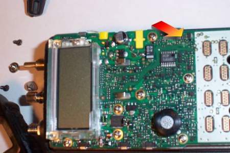

一直在折腾这事情。想搞清楚。网上搜了很久。找到一些(有一个在mods.dk这个网站,但是要收费,没看到)。
自己联系网上说的,还有别人的回帖,总结了一下,麻烦已经扩过的人帮忙看看,看正确不??(慎重慎重再慎重哈)
第一步:扩到420-470收发。有些机器买来是430-440收发的(现在买的好象大多是420-470收发拉,早期买的有)

只看该作者 2楼 发表于: 2006-03-08
arthur: ukflyer
notes
mod will give tx 137-174mhz and 420-470mhz and is verified for us spec radios only.
mod involves removal of an extremely small surface mount resistor. do not attempt if your skills are not up to it. irreparable damage could occur to the radio.
mod does not make radio compliant for cap use; it may also void your warranty.
do not ever transmit on a frequency you are not licensed for.
http://www.mods.dk/mod/yaesu/ft-60_mars-3.jpg

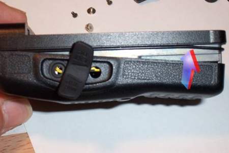

take out the rubber plug for the mic and dc sockets and swivel it around 90 degrees.

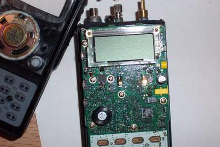

carefully remove the body of the radio from the front panel. ease it out from the bottom first making sure you don’t damage the rubber waterproof seal that goes all around it. separate the lcd section from the front section.
http://www.mods.dk/mod/yaesu/ft-60_mars-4.jpg
http://www.mods.dk/mod/yaesu/ft-60_mars-5.jpg

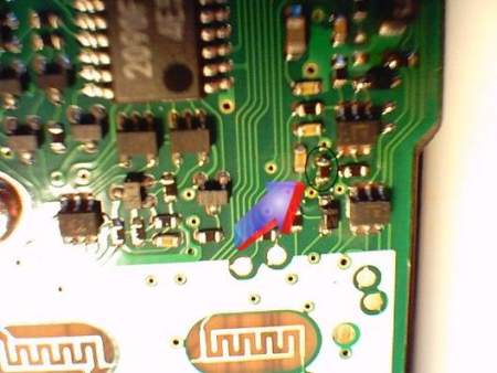

remove r1164. this is found on the right side of the radio, on the board just above the keypad area.
http://www.mods.dk/mod/yaesu/ft-60_mars-6.jpg
http://www.mods.dk/mod/yaesu/ft-60_mars-7.jpg
reassembly is the reverse of the disassembly.
this mod is provided for reference only.
performing this mod will erase all memories and re-set the radio. perform at your own risk!
instructions

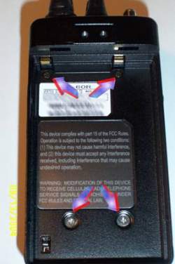

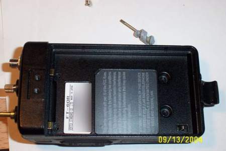

remove belt-clip and battery
remove the 4 screws (2 silver and 2 black) in the battery compartment.
http://www.mods.dk/mod/yaesu/ft-60_mars-1.jpg

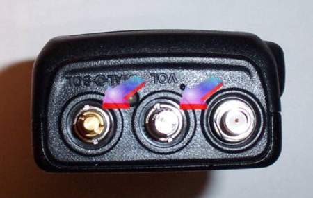

remove antenna and pull off the knobs
http://www.mods.dk/mod/yaesu/ft-60_mars-2.jpg
with tweezers or needle nose pliers, carefully remove the rubber gaskets around the knob shafts.
unscrew the two split nuts from the knob shafts

tx应该可以扩到:400.000~503.560(5k步进); 400.000~503.900(12.5k步进).[不知何原因?]
不过发现在503.000兆以上的tx不是很稳定,tx功率是多少没有测试过。

扩频后发现发射功率不稳定,电流较大。还是去回原样。
离线bg7irh
20
只看该作者 7楼 发表于: 2006-03-11
你就好啦!!!!!!为什么不早点发帖????我的ft-60""""""""烧了!!! u段全无功率! v段只有0.1w!!!! 我也发现扩频后,发现发射功率不稳定,电流较大。[好惨啊!!!!!扩频后烧机]

我的60r按照上面的方法扩频了,现在可以在400-420这一段工作了,感觉功率和灵敏度很好,只是原机天线在这一段不太匹配,所以尽量不要用大功率发射.
想改回144-148/430-440,请问r1164和另外一个元件是什么规格?

转发:ft-60r扩频后频偏和步进问题
ft-60r扩频后在u段可以下扩到400mhz发射,测试了一下发射电流为1.5a,功率有5w。在409mhz免照段试验了一下,发现409mhz免照机接收有中断。原来409mhz免照机的工作频偏只有2.5khz,而一般的对讲机工作频偏是5khz。故用一般的对讲机与409mhz免照机通话时,因为频率偏移超出了409mhz免照机的接受范围,所以409mhz免照机接收有中断。好在ft-60r可以通过修改元素编号为的55选项:55 wid.nar,
选择宽窄【±2.5khz】的发射偏移 (narrow)后便可以正常使用了。故喜欢扩频的朋友在选购机器时应该注意机器是否具有可变发射偏移的功能。
