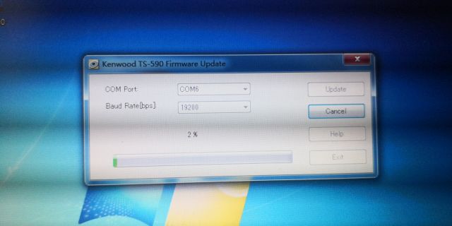

升级2.0完毕后,打开590菜单,把65菜单正确设成电脑com几,才能打开590自带软件

请问,这个如何设置?没看懂,我昨天升级后,LOG32连不上了,MMV也连不上了~~

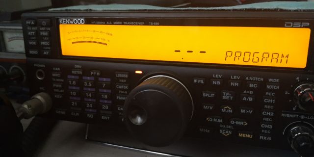

升级以后是复位,你没有提前在建武自带软件程序里保存你590机器菜单的参数,什么都复位了,所以你要从头进入590菜单里设置;com-波特率等,用功放别忘设53号菜单否则功放不起控。。。

我全部按原来的菜单搞了一遍,应该没问题,HRD能用,但就是LOG32    MMV都不行,怪了,ARUA-10那里是个红圈带斜杠,是不是USB没通?但HRD就没问题

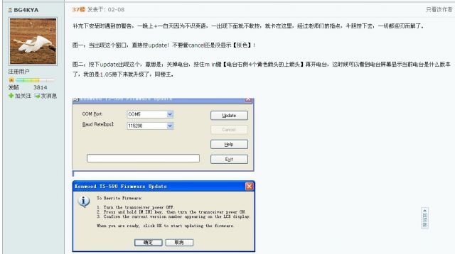

The HF/50MHz All-mode transceiver TS-590S firmware has been updated from Version 2.02 to Version 2.03 as follows.
We are offering the firmware updating program to the TS-590S owners.
You can update the TS-590S firmware by connecting the TS-590S to the PC by using a USB cable or an RS-232C cable.
The firmware updating program is not applicable for the TS-590SG.
The TS-590S is no longer in production. The firmware updating program Ver.2.03 is applicable for all units of the TS-590S.
Attention
    Updating the firmware from Ver.1.08 (or before) to Ver.2.03 resets the transceiver automatically due to internal memory address reallocation. If you do not want to lose user data, save the data using the latest version Radio Control Program ARCP-590 (Ver.2.02) before updating the firmware and write the data back after updating the firmware.
About virtual COM port driver
    A virtual COM port driver needs to be installed onto the PC to use the firmware updating program with a USB cable.
     ATTENTION:Do not connect the transceiver to a PC using a USB cable before installing the virtual COM port driver.

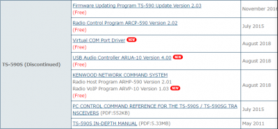

AMATEUR RADIO PRODUCTS SOFTWARE DOWNLOADS / KENWOOD  http://www.kenwood.com/i/products/info/amateur/software_download.html
https://www.kenwood.com/i/products/info/amateur/software_download.html
