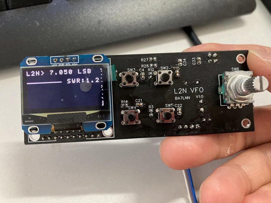

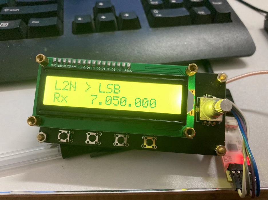

固件已经上传了!
传送门:https://ba7lnn.hingtak.com/2023/05/29/l2n-1206-12c5-dds.html
VY 73
BA7LNN, 2023.07.22
