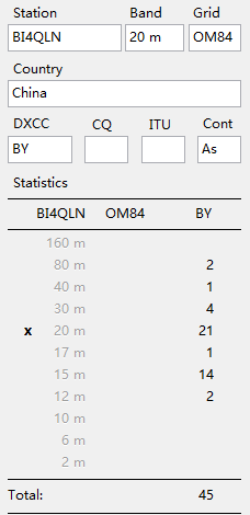

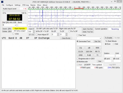

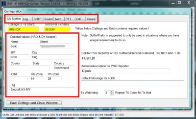

比较重要的修改 参照作者的readme 以及下图
版本信息:JT65-HF HB9HQX-Edition 0.9.86.9/Rptr V1.4
Amateur Radio software for transmission/reception of
JT65 protocol on HF bands 2m - 160m.(new: 6m & 2m)
0.9.82.0 and 0.9.86.9 cooperates with JT65-HF Image Controller from JQ1HDR
> http://jq1hdr.uzusionet.com/easypal_eng/index.html

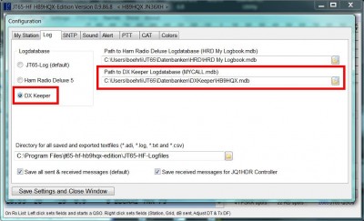

New: Access to HRD My Logbook.mdb and DXKeeper (Mycall.mdb) via ODBC.
Characteristics:
- Fast decoder
- Log database (SQLite)
- Dupe checking
- Optional: Acoustic alert
- Optional: Adjust time via internet timeserver (SNTP)
- Optional: CAT with OmniRig or HamLib
- Optional: Raw Decoder, Station Infos, Band Statistics
- Optional: Callsign labels in waterfall display (new)
JT65-HF Is (C) 2008...2011 J. C. Large - W6CQZ
Comfort-3 (C) 2012
HB9HQX-Edition (C) 2013-2014 B. Oehrli - HB9HQX
Readme – Version 0.9.86.9
The program is mainly based on W6CQz, Joe Large's JT65-HF (read "About JT65-HF").
It follows the same philosophy as the original, though many portions of the program
have been recoded.
Note: The database with configuration and other informations will be replaced.
      You must set some values, like
      Callsign, Grid, Logdatabase, Audio Device, COM port, CAT, Alert,
      after first start of the new release.
The main features of the program:
- Clearly arranged mainwindow with 4 additional windows:
   - Raw Decoder
   - Station Infos
   - Band Statistics
   - Output Level
- Easy to use with
   - quick decoder,
   - Rx-list (with Tx-messages) and
   - callsign-labels of calling stations in waterfall display.
- Automatically checks for duplicate new DXCC and new grid (different colors in RX-list).
- Shows azimuth and distance (calculated form grid squares in km or mile).
- Shows name of operator if available for use in messages.
- Optional:
   - Acoustic alert after decoding.
   - Fix Tx DF for split mode in JT65.
   - Automatic adjust DT (same time as partner station).
   - Adjusts the program time with a internet timeserver (SNTP).
   - Spots received messages to pskreporter.info and/or JT65 RB Network.

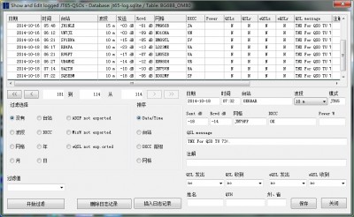

   - Generates the file JT65hf-log.csv to cooperate with the
     JT65-HF Image Controller from JQ1HDR.
- All settings saved in a database (jt65-config.sqlite).
- All imported and logged QSOs saved in a database (jt65-log.sqlite).
- Edit logged QSOs (use Filter(s) and/or ordering to edit your logged QSOs).
- ADIF: Import/Export log files (also used for eQSL).
- MixW: Import/Export log files.
- Import text files containing callsigns and names.
- PTT via COM port: RTS or DTR line (or VOX).
- Optional: CAT control with OmniRig.
  (OmniRig must be installed and configured prior to using this feature).
- Optional: CAT control with Hamlib.
- Hamlib and OmniRig: PTT via CAT or COM port (or VOX).

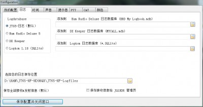

New in 0.9.86.9:
- Selection of one of three different logdatabases in config window.
  - jt65-log.sqlite: Default logdatabase of JT65-HF HB9HQX-Edition
  - HRD My Logbook.mdb: Logdatabase from Ham Radio Deluxe 5
  - mycall.mdb: Logdatabase from DXKeeper
- Config window with new design (more tabs).
- Station Info shows also continent, CQ- and ITU-zones
- Bug in dxcc.sqlite (missing prefixes and countries) is fixed.
- No more remove striplines (-------) in Rx-list.
- New behavior of the edit names dialog window for easy insert
  operator names in the names database (e.g. from QRZ.COM).

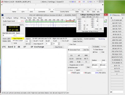

追加一项 併用外挂 JTAlert用户需要注意
(**作者答应可能需要1-2天时间修改JTAlert版本)
The latest release of JT65-HF HB9HQX, ver 0.9.86, will not work with JTAlert 2.4.20
The next release of JTAlert will have the necessary changes to restore functionality.
As part of the code changes, JTAlert will pause during startup and wait until a copy
of HB9HQX is detected running. This new behaviour is necessary because HB9HQX
has changed its configuration file structure and JTAlert needs to read data from
that file to complete its startup which can't complete until the version of HB9HQX
is correctly identified.
de Laurie VK3AMA

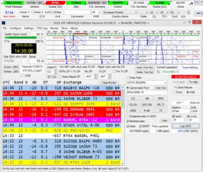

初试第一个QSO
有待观察82版本的修正情况.....

感谢楼主的信息,下载试用了一下,发现功能比较多,很实用,但发现一个无问题,QSO结束往 hamradio deleux 数据库写入 log 时报错,并且程序崩溃,不知是何原因,我用的 hrd 是 v6 的。

这个版本的 jt65-hf 功能多,好用,已经找到日志写入 hrd 数据库的问题,就是在通联结束保存日志时,空白的 PWR 这一栏不能是空白,填入功率即能保存。但感觉似乎不太稳定,我使用中已经数次碰到弹出 “devided by zero" 然后 crash 的情况,不知和我用的 win8.1 64bit 系统有关。

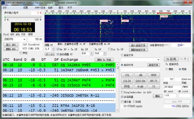

最近又更新了~操作比标准JT65方便~不过这个软件解码能力好像差一点~

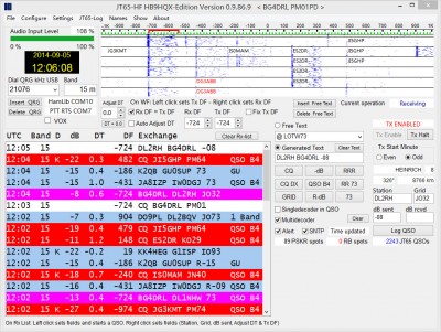

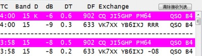

只看该作者 18楼 发表于: 2014-10-19
Re:感谢HB9HXQ
离线BG6BB
373
只看该作者 19楼 发表于: 2014-10-19
回 BG4DRL 的帖子
BG4DRL:[图片] (2014-10-19 14:35)
要是能通到就更厉害咯~
