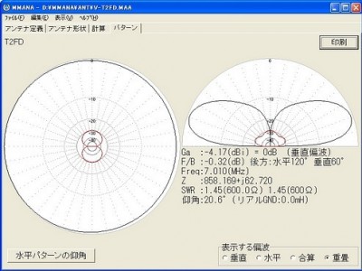

18967
只看该作者 28楼 发表于: 2013-08-22

离线BG0APD

只看该作者 29楼 发表于: 2013-08-22
Building the Balanced Termination Folded Dipole, (BUXCOMM 1606T2FD-1400)

The T2FD, modified to a Balanced Termination Folded Dipole (BTFD)

    The original Tilted Terminated, folded dipole (T2FD) was the design of amateur radio operator (An Experimental All-Band Non-directional Transmitting Antenna" by Gil L. Countryman, W1RBK, (W3HH), QST, June 1949), the antenna was first used for maritime and naval communications.
      It was 1958 when I built a modified version of the T2FD.  Instead of using the 800 ohm, non-inductive termination, I used an 450 Ώ Non-Inductive termination, and added the Guanella version of a transmission line transformer (TLT) 9:1 BALUN.  Our balanced termination, folded dipole (BTFD)  provided an excellent bandwidth using the tilted terminated, folded dipole (T2FD)  designed for a low frequency with the upper frequency limit extending well above 50 megahertz.  The articles I've read indicate the Tilted-Terminated-Folded-Dipole (T2FD) installed with the 30 degree incline, would exhibit an omni signal pattern..
      This is not quite the situation, as I've found the direction of the slope is favored as the direction of the main lobe.  Still the tilt or slope of 30 to 45 degrees is the recommended installation method.
   In 1966, while doing some experimenting with the balanced, termination folded dipole, I installed it using Mutt & Jeff masts, one at 30 feet, and the shorted one at 7 feet, providing approximately 35 degrees incline.  After several contacts, it was soon very obvious there was a lack of back-fill in the direction back of the incline.  To circumvent or at least correct some of the back-fill problem, I raised the high end (tall pole) to 35 feet, and brought the low end to slightly over 6 feet.   After all the raising and lowering of the ends, the antenna’s signal still favored the slope side or direction of the low end.  In subsequent tests I raised both ends of the T2FD to horizontal, and found that it gave us a good omni pattern, but was not as effective as when it was installed as a sloped antenna.  SEE FIGURE 1;

    The balanced terminating resistance (BTR) becomes more critical as the feedpoint impedance is lowered.  With lines of lower impedance the BTR value becomes more critical, to within about 25 ohms.  Some builders who do not know or understand this, use a low value of 390 to 400 ohms, some as low as 200 ohms.  They do so in order to use a more available BALUN and/or BTR.  This too adds to the problem relating to the gain/bandwidth factor of this antenna.  We recommend using a balanced termination resistor (BTR) greater than 500 ohms.  To be on the safe side, use a 450 ohm BTR (BUXCOMM model 450TR), and a 9:1 (BUXCOMM model B15C91) BALUN.
To determine the dimensions of a BTFD or T2FD using 450 ohm termination and 9:1 BALUN use the following formulae to calculate the dimensions.  Use 50.000 divided by F (frequency in Mhz).  To make the calculations linear when computing dimensions for bands other than the bands used in the examples below.
Example, to calculate a T2FD for 80 through 10 meters; divide 3.7 Mhz into 50.000.  50/F then to convert from meters to feet, multiply by 3.28:
Length = 50.000 divided by 3.7, = 13.5 X 3.28 = 44.4  or approximately 44.5 ft.

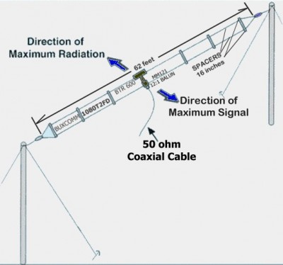

Figure 1:  Several installation configurations for the The balanced termination, folded dipole (BTFD)  BUXCOMM model 1606FD-1400

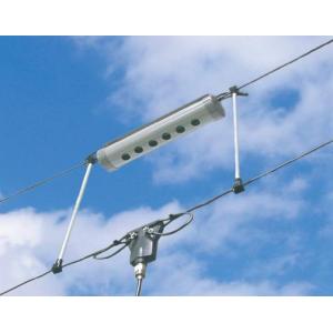

The tilted terminated folded dipole (T2FD) is an extremely broadband antenna, and it is a very quiet antenna indeed, as it is immune to terrestrial noise as compared with a vertical or a horizontal dipole.  The SWR, Standing Wave Ratio, when transmitting may vary from an almost perfect match of  1.1:1 at some frequencies to 2.5:1 at other frequencies.  In either case, either reading is good when you consider you are able to operate across the HF spectrum without an antenna tuner.
Tilted, Terminated, Folded Dipole (T2FD) BUXCOMM model 1606T2FD, Low-Noise, High-Performance, T2FD Antenna.

* Length, 25 meters
* Passive, therefore no inter-mod
* Antenna is completely factory assembled and, ready to erect.
* Heavy duty construction, both wire and fiberglass.

Figure 2:   Properly installed, balanced termination, folded dipole (BTFD)  is omni-directional over most of its operating range.

    This 30 to 35 degree angle enables the antenna to be sensitive for horizontally polarized, as well as vertical polarized signals.  This feature is where the T2FD exhibits one of its inherent properties; Reduced signal fading.

只看该作者 31楼 发表于: 2013-08-22
虽然看的不太明白,但是知道了T2FD天线的辐射方向,这才是我最关心的。

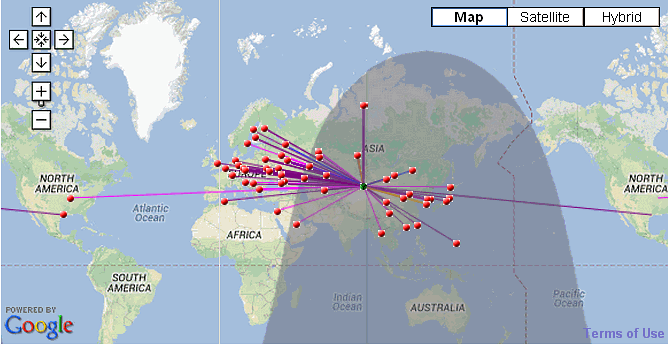

离线BG0APD
8463
只看该作者 35楼 发表于: 2013-08-23
回 BG4AJU 的帖子
BG4AJU:楼主的天线,在上一世纪专业单位用的很普遍,天线有着良好的接收效果,短波宽频段,低驻波比。发射效率低,可以使用大功率电台弥补。 (2013-08-23 13:38)
谢谢,现在先接收,替站长的RBN检测信号,还好歪打正着。
