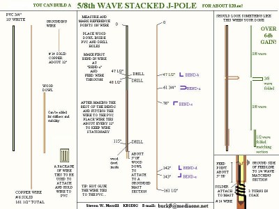

用铝塑管做好了,但效果不行,图纸参数不详,上端用3/8波长折制的上下口径是多少?下端u型左右口径是多少,
5"约合16.66cm对吗,5/8波长约1.2328米(*0.96缩短率),3/8约0.7397(*0.96)

请问400m的怎么做,下边的匹配还是饶三圈吗?我想把折合部分折回来,和j型折合天线那样,不也是倒向吗?这样不是长度也短些,好做些吗?

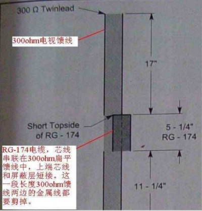

Slim-Jim 2m VHF Band Antenna
slim-jim 2m vhf band antenna
submited by nadisha 4s7nr
slim-jim is easy to built, no radial 145mhz antenna. it has almost equal gain of a 5/8 lambda (did not measure with any professional equipment, but my ft23r s-meter shows equal readings on both antennas) and much higher gain than 1/4 lambda whip. but it is much easier to buld than a 5/8 or 1/4 antenna. this looks like a modified j pole. i am sorry i don抰 know who invented this, but some one who has done a good job.
to built this antenna you need 3/4 inch (even 1 inch is okay) diameter, 5 and half foot or longer pvc pipe. no 14 to 18 copper wire slightly longer than 10 feet. as shown in the picture make a hole (just enough to put the no 20 copper wire) across the pvc pipe from the one end of it. make another one exactly 60 inches (5 feet) below the first hole (that is the bottom end of the antenna). at the bottom end you should have at least about half foot pvc left to fix it somewhere. between two holes is length a (see pic).
a = 60 inches
b = 19 inches from the bottom
c = 40 inches from top
d = 3 inches from bottom where the coax is connected.
g = 1 inch gap (no connection).
when you connect the coax, do not connect it as shown in the picture. i draw it only to show the connection. but connect the coax up side down so the water will not go in to the coax. center connector of the coax should connect to the opposite side of the gap. if you want to change the matching, try to change the distance of d.
also at the end you will have to put some tape, around the pvc from few places, so the wire will not move here and there. - good luck!

/8-WAVE COLINEAR "OUTSIDE PVC" 2-METER 146 MHz FM J-POLE
折合倒相的“耳朵”部分可以不可以这样来做。。。。
