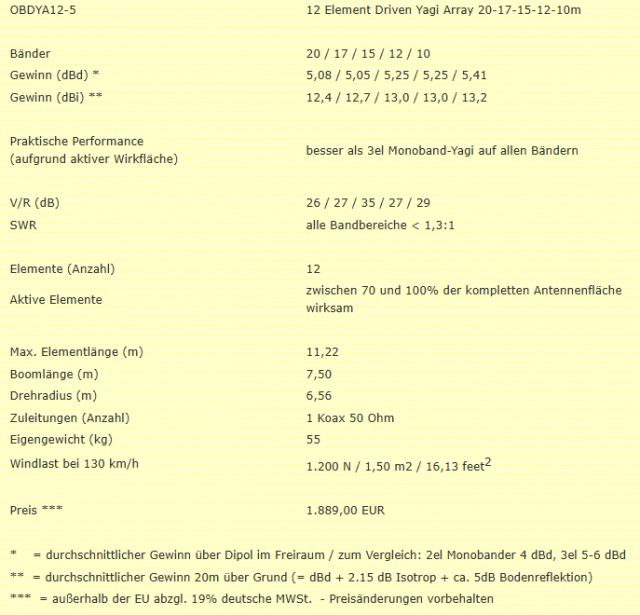

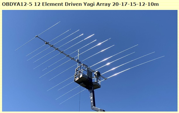

OBDYA12-5为例介绍一下DYA技术。
尽管 OBDYA12-5 是一个 "全驱动系统",但它与对数周期天线完全没有关系。
对数周期天线基于一个固定的数学对数,它定义了从一个振子到下一个振子的长度差和它们之间的距离。
其结果是增益相当低,而且 f/b 比也不是很好。
与我们以前和部分仍在使用的对数八木天线(LY)相比,DYA(驱动八木阵列)系统更胜一筹。
它将逐步取代所有对数八木天线,而它们已经是性能卓越的产品。
OBDYA12-5 OBLY14-5 的后续产品,同样的臂长 =7.50 米,12 个振子,但增益更高,f/b 比更大。
OBDYA 是所谓的 "全驱动系统",其中 11 个振子以非常特殊的方式馈电(有些振子同相,有些振子相移 180 度,绝对独一无二,以前从未有过),另外还有一个寄生导向器(至少与 LY = 对数八木系统相比是相同的)。
全驱动系统具有以下优点(如上所述):
1. 原则上是无损耗系统,而像标准八木天线那样相互耦合的振子总是有某种损耗
2. 八木天线具有一定的 "峰值性",即在整个波段范围内增益和模式都不稳定,而全驱动系统在这方面非常稳定。
3. 全驱动系统的整体模式要好得多,f/b 比更高。
附件自由空间的数值证明了所有波段与 3el 单波段八木天线性能,甚至具有更高的 f/b 比,这就是天线从开始到结束所有五个波段的性能。
这就是天线 "纸面上 "的性能。
在实际应用中,由于辐射 = 捕获面积大(所有振子始终处于电流下),它甚至可以显示出更多的性能,因此在实际应用中,OBDYA12-5 就像一个 3.5el 的单波段八木天线,甚至可能更高一些。
这真是一个令人难以置信的天线。
特别是在 17m 15m 上,有更优秀的性能。 OBDYA12-5_plots.doc (358 K) 下载次数:3

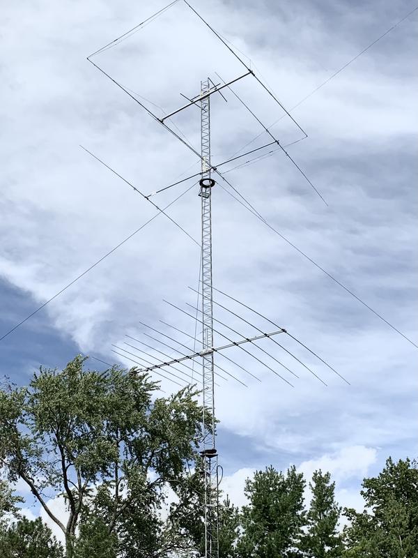

★★★★★5 out of 5 stars.    BILL · a year ago
No buyer's remorse
This Optibeam OBDYA12-5 antenna covers all radio amateur bands between 14 and 29.7 MHz with a single feedline from the radio shack. No band-switching is required at all. This antenna has been in use at my location for over one year.
At first glance, this antenna appears to be a log-periodic array. But is it? The manufacturer identifies this antenna as a 12-element driven yagi array. Inspecting the construction guide supplied with the antenna gives us the answer.
Log periodic antennas are multi-element antennas characterized by logarithmically decreasing element size along the antenna's length and providing broad bandwidth coverage. Radio amateurs use these in applications where a wide frequency range is required.
On the other hand, two-element phased antennas consist of two or more closely spaced individual antennas, often half-wave dipoles, that are connected to a common feed point and have their signals combined to produce a directional radiation pattern. We use them in applications requiring a directional signal, such as long-distance communication.
The main difference between log periodic and two-element phased antennas is that periodic log antennas are broad-band antennas, while multi-element phased antennas are directional narrow-band antennas.
This Optibeam antenna is not a periodic log antenna. Instead, it is a series collection of narrow-band antennas, each of which is two or more elements, sometimes combined with either a shorted-stub reflector or a parasitic director.
The antenna described here is composed of multiple two or more elements antennas that, when combined, offer the wider frequency bandwidth of the usually larger log periodic antenna. The only drawback is that this Optibeam antenna does not give frequency coverage for radio bands outside the standard bands. However, we don't care about this!
The comprehensive frequency coverage is evident, mainly where the impressive ten-meter band exhibits low SWR across the spectrum, up to 29.7 MHz.
This antenna's observed front-to-back and forward gain performance are consistent with the published specifications. In addition, it works as an excellent three-element monoband antenna on each frequency segment.
How high is this multi-band antenna mounted?
I mounted this antenna at 52-feet on a rotating tower. This height is almost equal to a length of 3/4 wavelength on 14 MHz.
A 3/4 wavelength antenna can be a good option for HF (high frequency) radio communications, as it provides a good balance between gain and directivity. This antenna height is commonly used for long-range, directional communication and can perform well in the HF band.
The photograph shows this antenna mounted lowest on the tower at the height of 52-feet.
Bottom line: there is no buyer's remorse with this antenna. Both mechanical construction and electrical performance are consistent with the Optibeam OBDYA12-5.
