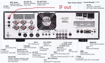

原来洋土豪们也用 SDRplay 做IF 频谱扩展器啊 具体查看原帖
点击图片放大
http://www.sdrplay.com/community/viewtopic.php?t=540

SDRPlay as Pan Adapter/Spectrum Scope for FTdx5000
http://www.sdrplay.com/community/viewtopic.php?t=552
by N6PET:
Thank you! I got it to work  ;) . I am using the RCA IF Out of the FTdx5000. Its working exactly as we intend it to with HDSDR. I'm still figuring out how to adjust the IF bandwidth with SDR-Radio Console. HDSDR was pretty straight forward, EXTIO , set IF bandwidth to 8Mhz, then fine tune it but I am searching where the equivalent setting is for the SDR-Radio Console since I actually like Console better.
Thanks again for all the help and appreciate it more if anyone knows how to configure SDR-Radio Console to function the same way.

IF Output FT-5000 vs FT-2000/IF-2000
http://www.eham.net/ehamforum/smf/index.php?topic=107172.0
WE1X:
I've been using various SDRs as panadapters with my TS-590S and TS-990S including the SDR-IQ, Afedri SDR-Net, FunCube Pro+, and SDRplay.  I noticed the SDR-IQ's clipping light would flicker when I would initiate an SSB transmission and SDR-Radio Console would display the message to reduce gain. The various SDR applications such as SpectraVu, SDR-Radio, HDSDR allow you to reduce the gain. However, I found that reducing the gain say by 10dB would defeat the purpose of using the SDR-IQ as a panadapter. In the end, the SDR-IQ what gain ahead of its ADC while other SDRs do not. This is likely the challenge.  I currently use the SDRplay and it appears to work fine. No, it doesn't appear to have the dynamic range as the SDR-IQ or higher-end SDRs, but for this application I think that's okay.
Harry WE1X

楼主 连接5000是用图一 还是要买个三通呢 原贴没看明白
