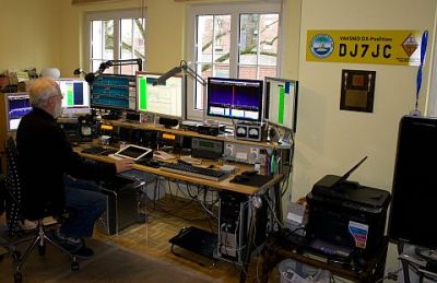

请参考以下帖子:
https://community.flexradio.com/flexradio/topics/connecting_an_expert_1k_linear_amp
其中,DJ7JC的方法如下:
Hi Kevin,
you need DDUtil V3 which you have to connect via the SmartSDR CAT
1.I have connected the Expert 1K via the RS232 connection of my PC tothe S232 Input of the Epert. There you have to select this port in thesetting menue under SET>CAT>SPE RS232 .
2. In the DDutil V3. Setup select
Enable SPE 1K-FA and com 1
I can send you by email my screenshots if you have still problems. Thawill be the easiest way to lean how to configure SmartSDR CAT DDUtil ec
vy73
Norbert
email: dj7jc@t-online.de
www.dj7jc.de
以上的大意是:
通过DDUtil V3工具软件,实现SmartSDR软件和1KFA功放的自动控制,
1KFA功放的串口,电脑的串口连接,
DDUtil软件和SmartSDR Cat软件连接,获取收发机的频率,
在DDutil软件里面,打开控制SPE 1K-FA功放的选项,并且选择适当的串口。
