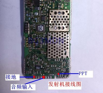

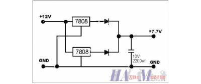

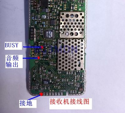

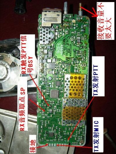

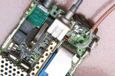

摩托罗拉88链路机.中继取点.上图[attachment=700328][attachment=700328][attachment=700328][attachment=700328][attachment=700328]
