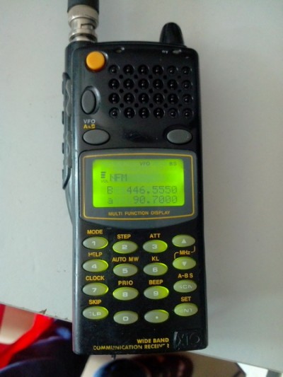

这里高手众多,请教这个“顺风耳”的操作方法及资料 [复制链接]
离线bg3sfx
401
只看楼主 倒序阅读 0楼 发表于: 2015-02-04
Frequency
Coverage:
100KHz ~ 2000MHz (no
gaps)
Mode:
WFM, NFM, AM, CW, USB,
LSB
Reveiver
System:
Triple Conversion
Super-hterodyne
Channel
Step:
50Hz, 100Hz, 1KHz,
2KHz, 5KHz, 6.25KHz, 9KHz, 10KHz, 12.5KHz, 15KHz, 20KHz, 25KHz, 30KHz, 50KHz,
100KHz, 125KHz, 150KHz, 200KHz, 250KHz, 500KHz, or Auto
Steps
Memory
Channels:
1200 Channels (40
channels X 30 banks)
Antenna
Impedance:
50 Ohms
unbalanced
Frequency
Stability:
Better than 10ppm (-10
~ + 50 degrees C.)
Sensitivity:
0.1 ~ 0.5MHz / AM: 10uV
(20dBu)
0.5 ~ 5MHz / AM: 1.5uV (3.5dBu), SSB/CW: 0.5uV (-6dBu)
5 ~
30MHz / AM: 1uV (0dBu), SSB/CW: 0.25uV (-12dBu), NFM: 0.35uV (-9dBu)
30 ~
1000MHz / AM: 1uV (0dBu), SSB/CW: 0.5uV (-6dBu), NFM: 0.5uV (-6dBu), WFM: 1.5uV
(3.5dBu)
1000 ~ 1300MHz / SSB/CW: 1.5uV (3.5dBu), NFM: 1.5uV
(3.5dBu)
1300 ~ 2000MHz / SSB/CW: 10uV (20dBu), NFM: 10uV
(20dBu)
AM/SSB/CW: 10dB S/N. NFM/WFM: 12dB
SINAD
Selectivity:
SSB/CW: -6dB/4KHz or
better
AM/NFM: -6dB 15KHz or better
WFM: -6dB 150KHz or
better
I.F.:
(1st)
736.25/275.45MHz
(2nd) 45.05MHz
(3rd) 455KHz/10.7MHz
(WFM)
Power Supply
Requirements:
4.8 ~ 13.8v
DC
Current
Consumption @ 13.8v DC:
At normal AF output:
200mA, squelched: 140mA, squelched with battery saver ON:
30mA
Operating
Temperature:
-10 ~ +60 degrees C, 14
~ 140 degrees F< /TD>
Dimensions
(with EBP-37N without projections) :
57(W) x 150(H) x
27.5(D) mm 2-1/4"(W) x 6"(H) x 1-1/16"(D) inches
Weight:
approx.
320g

刚刚收的?
离线BG2ISM
10179
只看该作者 6楼 发表于: 2015-02-04
价格多少?
  BG2ISM
离线bg3sfx
401
只看该作者 7楼 发表于: 2015-02-05
回 bg6ehy 的帖子
bg6ehy:刚刚收的? (2015-02-04 20:42)
是的,刚刚在隔壁收的,现在不太会用,SSB收不到台,有噪音

离线BG2ISM
10179
只看该作者 9楼 发表于: 2015-02-05
尝试一下切换接收模式,在不同波段切换,用817等全段全模式发射对比测试,模式不同不能解调但通常会有些杂音。
把设置里面的选项全部对照词典查一遍
  BG2ISM
离线bg3sfx
401
只看该作者 10楼 发表于: 2015-02-05
回 BG2ISM 的帖子
BG2ISM:尝试一下切换接收模式,在不同波段切换,用817等全段全模式发射对比测试,模式不同不能解调但通常会有些杂音。
把设置里面的选项全部对照词典查一遍 (2015-02-05 12:01)
现在是调不出菜单来

收ssb连r20都不好收.这个就死了心吧!
