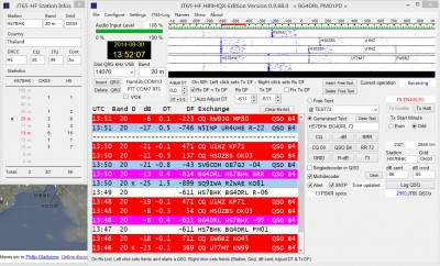

感谢HB9HXQ - JT65新版 HB9HQX-Edition v0.9.88.0 [复制链接]
只看楼主 倒序阅读 0楼 发表于: 2014-09-30
BUG订正&增加功能如下
Readme – Version 0.9.88.0
The program is mainly based on W6CQz, Joe Large's JT65-HF (read "About JT65-HF").
It follows the same philosophy as the original, though many portions of the program
have been recoded.
Note: The database with configuration and other informations will be replaced.
      You must set some values, like
      Callsign, Grid, Sound Device, COM port, CAT, Log, Alert, SNTP and Color settings
      after first start of the new release.
      Move window "JT65-HF Output Level" away from mainwindow and set Dial QRG.

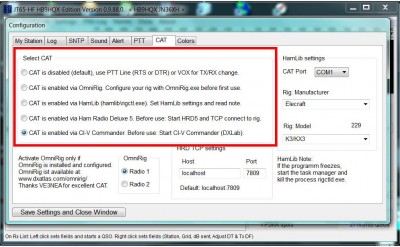

- Optional: CAT control with OmniRig.
  (OmniRig must be installed and configured prior to using this feature).
- Optional: CAT control with Hamlib.
- Optional: CAT control with Ham Radio Deluxe 5.
- Optional: CAT control with CI-V Commander (DXLab).
- If CAT control: PTT via CAT command or COM port (or VOX).

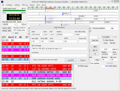

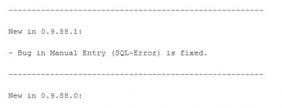

New in 0.9.88.0:
- Log QSO in HRD My Logbook.mdb:
  Insert station callsign in 'COL_STATION_CALLSIGN' field.
- After import a new log database and click on the 'Log QSO' button,
  it appears a SQL error message. This bug is fixed.
- Following settings are not saved:
  'Auto Adjust DT', 'Fix Tx DF', 'Rx DF = Tx DF', 'Singledecoder in QSO'
  and colorsettings of entries in Rx-List.
  It uses always default values instead of the saved values.
  This bug is fixed.
- Changes of alertsettings have no influence of the alert test procedure.
  This bug is fixed.
- Fatal bug in access function to a DXKeeper logdatabase is fixed.
  (Program freezes with an ODBC error message, because missing data in a
  memofield, e.g. 'QSL_Via' or 'Name'!)
- Fatal bug in code for ptt control via COM port, if the same port is used by
  an other running program for CAT, e.g. HRD5 or CI-V Commander.
  This bug is fixed.
  If the selected port is missing or in use, then ptt via COM port is disabled.
- Changes in decodercode for a better decode result.
- New: Shows warning message if Dial QRG is not set. (Decodestep is skipped)
- New: Optional logging direct into the SQLite logdatabase of Log4om.
- New: CAT support of HRD5 via TCP.
- New: CAT support of CI-V Commander (DXLab) via TCP.

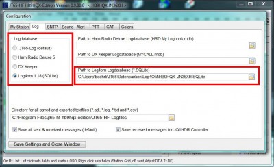

安装时需要注意的几点,特别是B4数据的恢复尤为重要
删除旧版本时,原先的QSO B4数据被删除 故需要导出后再导入 运行。
************First Steps after installation 重要!
Configuration:
1. My Station
   - Callsign
   - Grid
2. Sound
   - Audio Input Device - Rx
   - Audio Output Device - Tx
3. PTT Port
   - Select COM Number and test it
Main window:
1. Move window "JT65-HF Output Level" away from main window
2. Choose or type Dial QRG (Combobox)
3. Import ADIF logfile (backup from previous version)

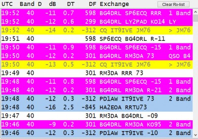

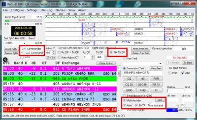

But 高要求的呼声 有着这样的评语
HB9HQX is performing these very fast decodes because it is not decoding all signals (as confirmed by several users when running H89HQX in parrallell to JT65-HF or WSJT-X). HB9HQX doesn't apppear to be using the "K" decoder to decode weak signals and is only using the fastest method of decode, so you will never get decodes of signals down to -27dB as you will get with the WSJT-X and JT65-HF. My tests have also shown that HB9HQX is not very reliable with crowded bands with many overlapping signals often presenting only 50% to 75% of the decodes that WSJT-X detects.
只看该作者 3楼 发表于: 2014-09-30
功能上有了非常大的改良
decoder虽然有不尽人意的地方 但相比 WSJT-X and JT65-HF有很强烈的直观性
与作者讨论 ,最好具有
VOACAP电波运搬预测的外部XML计算链接 ,来显示做Single/Long Path的可视化
图形数据的输出
现状的debug和用户切换状况如下:
TNX for JT65 QSO, gl & gdx & cuagn 73...!

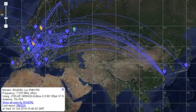

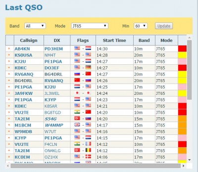

最牛13信号Get.....
皇道乐土...... 真舒服
这算是Pileup...吧.....!
DX me!  .....

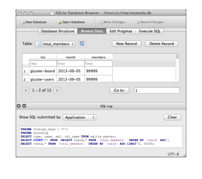

现在流行用sqlite
给大家留个链接  以后应该会用到  > 那边的喜欢比赛的兄弟们
http://sqlitebrowser.org/
