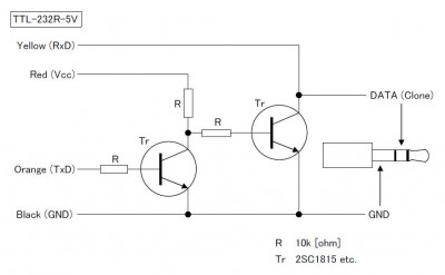

Alinco EWR7 cable
3483
Alinco EWR7 cable
BG4DRL
UID:360404
2011-07-07
2023-05-15
8155小时
发表于: 2013-12-24
BG4DRL
UID:360404
2011-07-07
2023-05-15
8155小时
发表于: 2013-12-24
推荐FTDI-232
