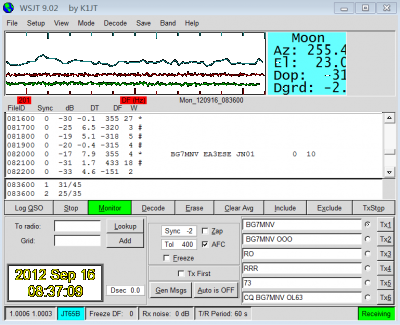

离线bg7mnv
112
只看该作者 62楼 发表于: 2012-09-17
弱弱的问:图中接收到的信息是网络的还是EME系统的?
http://www.qrz.com
离线BA7KW
16344
只看该作者 63楼 发表于: 2012-09-17
这个时延7.9秒有点不靠谱,正常在1-3秒间(大家都对过时,误差1秒内),可能你的时钟不准。
但你解读的信息是正确的,能收他的回复是很有可能的,这两天EME传播很好,损耗DGRD只有1.x到2.x,昨日和今日ECHO测试最好时都能收到-16.你可以试一试ECHO 模式。如果能够收到回波说明你的系统很正常。

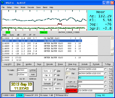

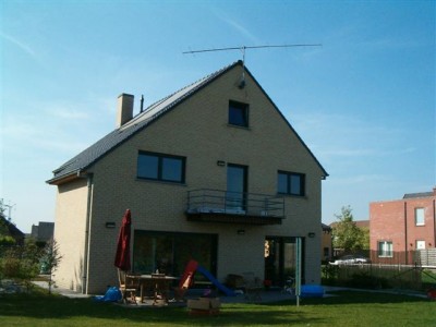

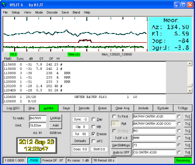

昨晚通了一个比利时的电台,他仅仅用一支12单元(约6米`长)的天线,不用旋转器,250W的乌龟。
我的设备是入门级,他的设备更是门外级,这样也能通上,真是神奇。
我收他的信号:
113900  1  -29  2.7 -406  2 *      BA7KW ON7EH JO20          0  10
115500  1  -31      -384  3   RO
他收我的报告和QTH的照片如图片
我当时一直在追他给我发“73”,但他在EME CHAT里面说,他收到我的“RRR"就表示已经结束QSO了,呵呵。后来还收到他的来信解析这件事,一个3代都是火腿的世家。
另一个信息是,比利时也用华为的基站,真是让人觉得骄傲。
他以前也和Sug通过。
他的来信:
Hi Jan,
“Nie haw”
I am sorry to hear about ur Rx-problems. It must not be easy to do EME  under such circumstances!
I copied you very well as you can see in the attached screenshot.
Normally, for a complete EME QSO it is sufficient that one station has  copied RRR. With the logger it is common to stop when the station has received  the RR and announces it to the other station. In attach you can find the proof.  (3xRRR)
If you think the QSO was not complete please let me know and I’ll try  another time...
Below you’ll find the usual, QSO details, I sent to stations after having  made a QSO via 2m EME...
It is always nice to QSO a new station with my single “baby”-yagi...
Thanks for the new initial
I am glad you came back to me after your CQ.
You were not visible then so apparently (and luckily) the polarisation  changed...
You will see on the screenshots that you were rather good copy, here... Two  earliers minutes were only seen but not decoded. (traces)
Your (antenna) system is working very well!
The degradation was average (@ –3.8dB) and that certainly helped a lot  because the conditions were rather good but not many stations active. (they were  all in Cambridge...Lucky me...)
You were best decoded at –21dB  during our QSO.
As said, I had many good decodes with CQ, OOO and RRR.
The QSO was started in my first and end of my first GG  lobe.
The antenna here is just 10m agl and 30m asl .
The QRM is getting louder and louder in the back of my antenna (many, many  houses) so I am very happy, I can work via the moon on my moonrise...!Remember, I have no elevation rotor here! Only at my moonrise, the groundgain makes that I can tx/rx as the  equivalent of a 5y station...!You'll find attached my moonrise view, the pictures were taken at 120°, the QTF during our QSO was even more to the right.I have still very good ground gain here...You also see a picture of my "monster" antenna, one 12M2  (2.87 lambda long=nearly 6m long) on the side of the houseThe QTH is near to Brussels airport.Station is 250W+ (TS850S + transverter), Kathrein 144MHz  bandpass filter, LNA is by PA3BIY in the shack and desktop 1.8GHz.Thanks a lot for the nice QSO!  Would it be possible to get a picture of your antenna system?At work I often work with Chinese engineers from Huawei! Huawei is  our 2G/3G/4G base station equipment provider! 73, Michel, ON7EH (also 2nd op @ON5RR 23/13cm EME)http://users.skynet.be/on7eh/  (not updated for quite some time  now)
I am 3d generation ham;
I am the grandson of Leopold Spelier (ex-EA5ASN, OQ5EH, 9Q5EH, ON4SP)
My OM QRO (father) was ON5SP, Roland Spelier.
Both are SK  now.

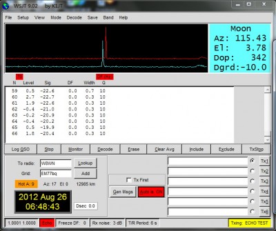

关于EME 回波测试的记录
分别是:编号,每6秒一个周期一次,电平,信号(dB),频率偏差,宽度,质量(这个最重要,0为不可靠,10为非常可靠)
记录时间约25分钟,可以看到反射的信号从-20的幅度,10的质量进过30个周期月180秒的时间变为没有了反射波被检测出来的-34,而再回到10的质量时,用了约300个周期即半小时,和前人总结的20分钟到1小时相符。其中也有部分时间能回到5-8的水平。对月反射通信,受法拉第旋转等影响,信号的飘忽还是很大的,但等一段时间也是有可能改善。其中规律我还在继续探索中。

离线BA7KW
16344
只看该作者 67楼 发表于: 2012-09-21

今晚试了EME 回波测试质量只有1,不好玩的.BD4SY说得对EME这玩意确实不是人玩的....
125254  Transmitting: Echo
   1  -6.1  -26.7   -52.2   0.3   0
   2  -6.3  -29.4   -52.2   0.7   0
   3  -6.3  -30.6    85.5   0.3   0
   4  -6.6  -32.2    85.5   0.3   0
   5  -6.7  -33.2   -35.7   0.3   0

离线BA7KW
16344
只看该作者 69楼 发表于: 2012-09-22
时间太短,做几个小时才准。
有反射时也不一定能QSO,相反无反射也可能通到他台。
你的设备不必比利时的那个ham差了,有机会做到QSO的。
