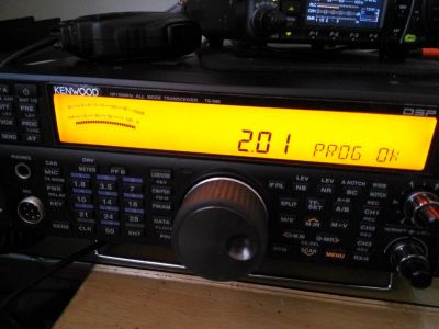

Advance Information “TS-590S Ver.2 firmware update” will be released at the end of January 2015.
http://www.kenwood.com/i/products/info/amateur/ts_590/ts590v2_e.html
Advance Information
“TS-590S Ver.2 firmware update” will be released at the end of January 2015.    October 2, 2014
We are to offer some of the new TS-590SG’s functions* to owners of our current TS-590S models via a free firmware download as "TS-590S Ver.2 update". The updated firmware will be available at the end of January 2015.
The “TS-590S Firmware Updating Program Ver.2.00” can be downloaded from KENWOOD website as well as other current firmware updates. The ARCP-590 and ARHP-590 control programs will also be updated to “Ver.2.00” at the same time.
*    The “TS-590S Ver.2 update” revises the functions which can be achieved by updating the TS-590S main CPU firmware. The “TS-590S Ver.2 update” does not include functions involving hardware updates, nor functions involving menu / display items which are controlled by un-updateable front panel CPU.
Main items of the “TS-590S Ver.2 update”.

只看该作者 84楼 发表于: 2015-01-29
生完了  我是不是第一名 Ver2.0用户嘿

升级2.0完毕后,打开590菜单,把65菜单正确设成电脑com口,才能打开590自带软件
海滨小城(威海)欢迎你!

只看该作者 86楼 发表于: 2015-08-02
直接从1.07升级到2015年07月28日2.01版本的呼哧路过!

2015,7,28升级2.01呀,别刷砖头啦!
TS-590S Firmware update information
http://www.kenwood.com/i/products/info/amateur/ts_590/ts590_update_e.html
