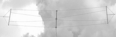

特点:
天线总长才7.5米,水平按装有8米可也.
在1.8~30mhz工作,swr小于1.7.
接收时超低噪音.
更详细的内容请看pdf文件吧.

okay it looks like a t2fd that has been folded over. usually they have a
load resistor“加载电阻” (600 ohms maybe) and a toroid matching transformer at thefeedpoint. (the antenna is close to 600 ohms without the transformer)
cebik explains how much loss this system incurs so you can make some
judgements from that.
the smaller capture area than a "real" t2fd may
mean another(损耗) 3-6db or so of loss.

貌似是行波天线

想了解是什么样的天线,看了一下楼主提供的附件中的图片,现将该文中的天线视图抽出,供大家参阅

这个小天线的原理估计与三线式宽频带的天线差不多
