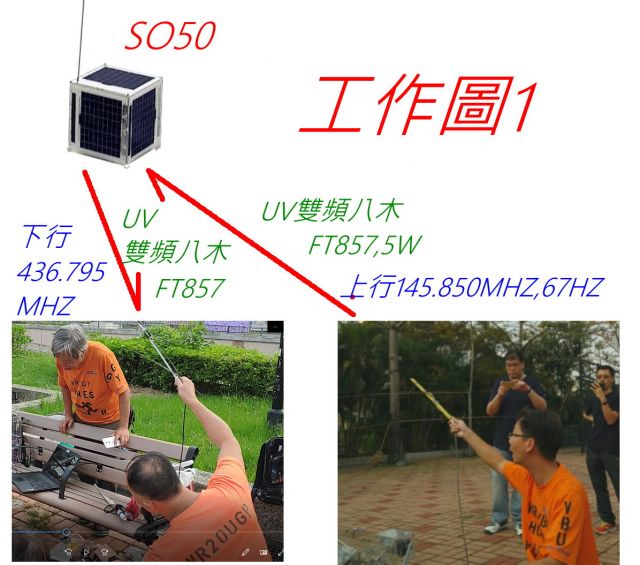

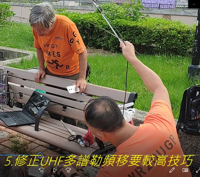

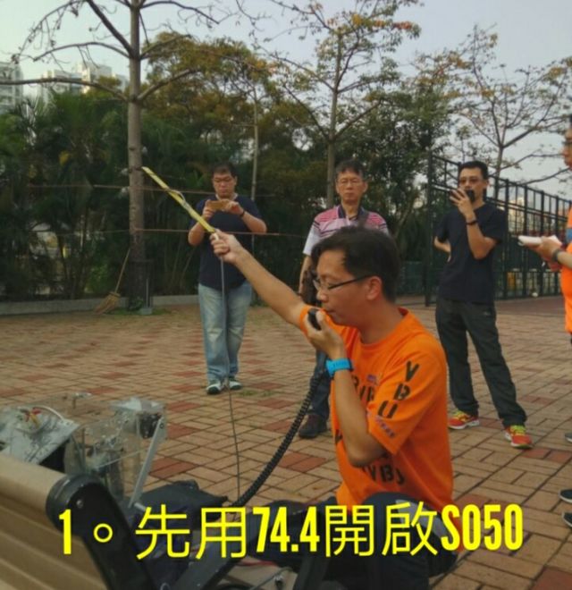

SO-50 satellite information
SO-50 carries several experiments, including a mode J FM amateur repeater experiment operating on
145.850 MHz uplink and
436.795 MHz downlink.
The repeater is available to amateurs worldwide as power permits, using a 67.0 Hertz PL tone on the uplink,
for on-demand activation. SO-50 also has a 10 minute timer that must be armed before use. Transmit a 2 second carrier with a PL tone of 74.4 to arm the timer.
The repeater consists of a miniature VHF receiver with sensitivity of -124dBm, having an IF bandwidth of 15 KHz. The receive antenna is a 1/4 wave vertical mounted in the top corner of the spacecraft. The receive audio is filtered and conditioned then gated in the control electronics prior to feeding it to the 250mW UHF transmitter. The downlink antenna is a 1/4 wave mounted in the bottom corner of the spacecraft and canted at 45 degrees inward.
