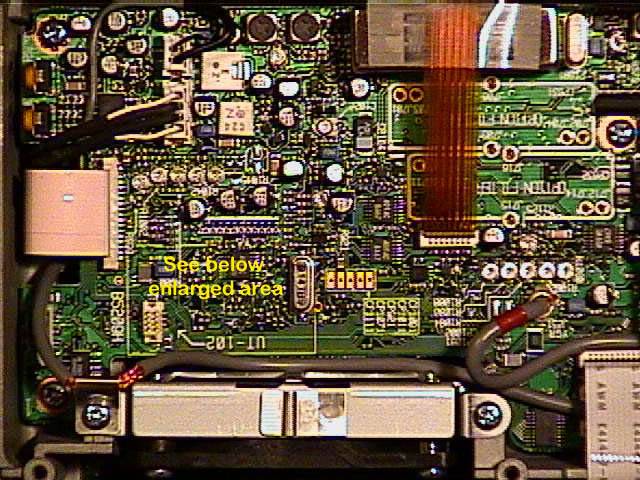

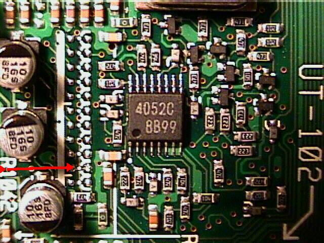

那就是说mkii的说明书已够用了,我在mods.dk的网站上看到这个,英文不行,只知道意思是功率可以调整到:
hf: between 125 watts and 150 watts (on 40mtr)!
6 mtr: 120 watts
vhf: 70 watts
uhf: 40 watts
深圳的muv好像已试过hf最大220w,150w可以长时间工作,不知还有哪位试过或者愿意试试。
for this mod you need an power meter and a dummy load!
open the transceiver case (top panel, 5 screws) as shown in the manual on page 59
locate r1082 (hf), r1084 (6 mtr), r1086 (vhf) and r1088 (uhf) see manual page 63
for adjustment r1082 (hf): power on the rig set frequency to: 14,100 mhz, mic gain: 5, mode usb and push ptt (don´t forget to whistle in the mic or use an audio generator set to 1,5 khz 30mv !)
the same procedure for 6mtr (set to 52,000 mhz), vhf (set to 145,000mhz) and uhf (set to 435,000 mhz)
turn above potis (r1082, r1084, r1086 and r1088) clockwise to maximum output
that´s it!
i have done this mode on my rig and i have no problems! my final is still ok!
my ouput power after the modification:
6 mtr: 120 watts
vhf: 70 watts
uhf: 40 watts
warning: doing this mod may eventually result in a damaged final transister and/or reduced service life!!
mod done by alex, hb9tsf, nh7vw
我又被点名了?ic-706mkiig有三个三菱rd70hvf1功放,其中一个用于u/v段,两个合成功率用于hf+50m,所以706的功率冗余量很大,好机器,不过别调太大功率,实践觉得hf120-150w长期使用还没什么问题。
根据706功放芯片技术参数可以知道以下:
uhf最大功率:50w(单个功放)
vhf:70w(单个功放)
短波:150w-220w(两个功放)短波底段比较高,高段没那么高
三菱rd70hvf1参数:
http://www.rfparts.com/pdf_docs/rd70hvf1.pdf
