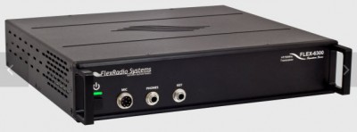

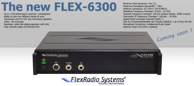

http://www.flexradio.com/amateur-products/flex-6000-signature-series/flex-6300/
Receiver Specifications
•Receiver Architecture: Direct Digital Sampling
•Spectral Capture Units:  One (1)
•Maximum Slice Receivers: Two (2)
•Maximum High Resolution Spectrum Displays: Two (2)
•Maximum Panadapter Width:  7 MHz
•ADC Resolution:  16-bits
•ADC Sampling Rate:  122.88 Msps
•Wideband Frequency Coverage:  30 kHz – 54 MHz
•DAX IQ Channels / Bandwidth Per Channel:  Two (2) @ 24 kHz – 96 kHz
•DAX Audio Channels:  Two (2)
•Amateur Band Preselector Coverage:  NA
•Preamplifiers / Attenuators:  0 to +20 dB
•Spurious and Image Rejection Ratio:  80 dB or better
•External Powered Speaker Output Impedance Level:  600 Ohm Stereo Unbalanced
Transmitter Specifications
•Transmitter Architecture:  Direct Digital Up-conversion
•TX DAC Resolution:   16-bits
•TX DAC Sampling Rate:  122.88 Msps
•RF Output Power:  1-100W nominal SSB, CW, FM, RTTY, Digital; 1-25W nominal AM
•Amateur Band Coverage at Rated Power Output:  160m – 6m
•Low Pass PA Filter Bands:  160m – 6m ham band only
•Transverter IF Output Power:  +0 dBm Typical; +10 dBm max
•Transverter IF Frequency Coverage:  100 kHz – 54 MHz
•Modulation System:  Digital Low Power at Carrier Frequency
•Maximum FM Deviation:  5 kHz
•DAX Transmit Channel:   Yes
•Carrier / Unwanted Sideband Suppression:  <80 dBc typ / <80 dBc typ
•Harmonic Radiation 1.8 – 50 MHz Amateur Bands:  <50 dBc; -70 dBc 6m
•Transmit Bandwidth:  Default 100-2900 Hz (Variable 50-10000 Hz)
•Microphone Connectors:  Unbalanced 8-pin Foster
•Microphone Impedance:  600 Ohms Nominal (200-10kΩ)
Antenna Tuner Specifications
•Matching Range 80m – 10m:  Optional, 8.3 Ohms – 300 Ohms
•Matching Range 160 and 10m:  Optional, 16.7 Ohms – 150 Ohms
General Specifications
•USB 2.0 Ports (peripheral control):   Two (2)
•Master Clock Frequency:  122.88 MHz
•Master Clock Phase Noise:  -140 dBc@10kHz
•10 MHz Reference Clock Stability:  0.5ppm TCXO
•GPSDO Frequency Stability (GPS locked):  NA
•Emission Modes:  USB, LSB, CW, RTTY**, AM, Synchronous AM, FM
•Frequency Resolution:  1 Hz min.
•Antenna Connectors:  SO-239×2, XVTRx1
•Antenna Impedance (w/o tuner):  50 Ohm Unbalanced
Electrical
•Power Supply Requirements:   +13.8V DC nominal ±15%
•Current Drain (Receive/Transmit Max):  1.7A / 23A @ 13.8V
Mechanical
•Height:  3.875″ (7.1 cm) with feet
•Width:  13″ (33 cm)
•Depth:   11.75″ (29.8 cm)
•Weight:  Approximately 10 lbs. / 4.5 kgs
•Operating Temperature:  0 to +50 degrees C; +32 to +122 degrees F
Options
•Antenna Tuning Unit (ATU); greater than 3:1 on 80-10m, up 2.5:1 on 160 and 6m
•Front Handle Kit (adds 1 inch/2.5 cm to total depth
Specifications subject to change without notice.
** Requires 3rd party software.

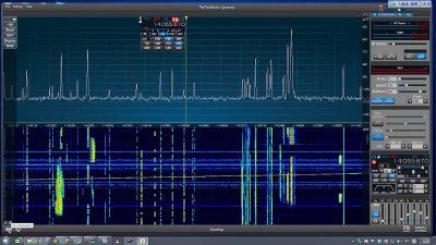

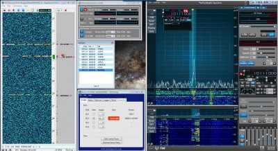

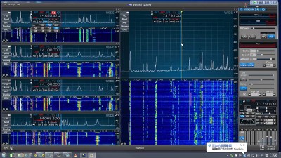

The Next Generation SDR software for the Next Generation SDR
SmartSDR™ for Windows sets a new bar for visual radio display and interactive control. Following the simple is better rule, we built a new graphical user interface that is easy to learn and instinctual to use.  Multiple high-definition, real-time spectral displays are at the heart of the SmartSDR experience.  Intuitive controls are hidden from view to minimize clutter yet are instantly available when needed.
SmartSDR is the core of the Signature Series family, organizing all of the signal processing power in the FLEX-6000 Signature Series radios into an advanced reusable framework.  First the receiver subsystems including preselectors, preamplifiers and digitizers in the FLEX-6000 are virtualized as reusable hardware blocks called Spectral Capture Units (SCUs) with specific capabilities.  SmartSDR understands the capabilities of each SCU and how to harness its power.
What distinguishes SmartSDR is the simplification of these advanced concepts into an elegant graphical user interface that places the operator in complete control.  Want to create an additional Panadapter to watch for possible 10m band openings?  No problem, simply click to add the Panadapter and SmartSDR directs everything from the advanced signal processing software down to the filters in the SCU to form an optimized receiver.  Want to decode all of the CW signals on 40m while working DX on 20m?  It’s just a few clicks away.

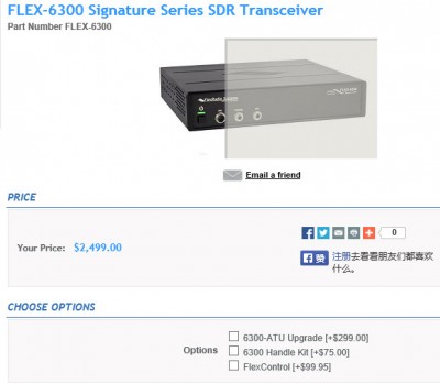

Flex-6300 本机 2499
Option ATU        299
=2800  约合 17500人民币 (对岸价)  要考虑5kg毛重运费和诸多杂费
其他Option
手咪 75
旋钮 99.95
大旋钮 flex做的很差(看图片)
这个option还是用 woodboxradio的液晶带旋钮 Tmate-2
如果这样配套的话 应该是非常爽的选择,台咪嘛5段icom类...............
卖掉手上的不用的,大伙应该可以合计下,
SmartSDR软件应该是Flex翻身的最重要武器,不会像PowerSDR没爹娘
估计flexradio当初软件开发者跑路了 才会那么糟糕。现在又博齐了....笑
