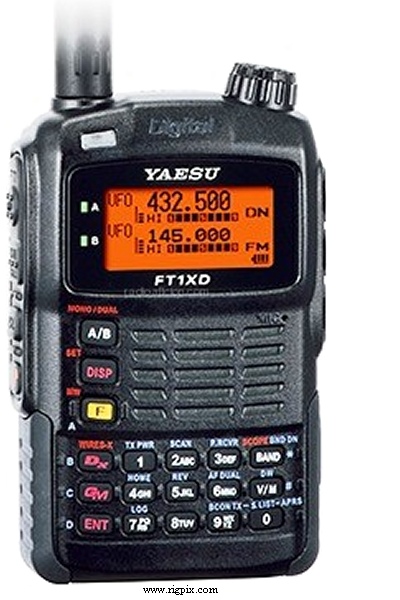

GENERAL
Type:Amateur VHF/UHF transceiver
Frequency range:TX: 144-146 /430-440 MHz (Europe)
RX: 0.5-999 MHz
Tuning steps:5 / 6.25 / 8.33 / 9 / 10 / 12.5 / 15 / 20 / 25 / 50 / 100 KHz
Mode:TX: FM/NFM/DV (C4FM FDMA, 9.6 Kbps)
RX: AM/FM/NFM/DV (C4FM FDMA, 9.6 Kbps)
Channels/memory management:900 regular
99 skip
50 PMS
11 home channels
10 WX presets
57 marine presets
89 broadcast presets
Repeater shift/offset:±600 KHz, 1.6 or 7.6 MHz (defaults depending on country). Other offsets are possible.
Power supply:7.4 VDC (battery pack) or 4-14 VDC external
Current drain/power consumption:RX: 45-240 mA (+30 mA GPS on) (+65 mA Digital on)
TX: Max 2 A
Antenna impedance/connector:50 ohms / SMA
Dimensions (W*H*D):60*95*32.5 mm (2.4*3.7*1.28")
Weight:290 gr (10.23 oz), with SBR-14Li and antenna
Other features:Built-in GPS. IPX5 water spray resistant. Vibralert. Internal AM bar antenna.
GSM function (Group Short Message, 80 characters). Micro SD card slot.
Snapshot function/Image transfer with optional camera-microphone.
Digital ARTS. USB port. Twin RX
RECEIVER SECTION
Receiver system:Single conversion superheterodyne (AM BC/WFM)
IF: 130 KHz
Double conversion superheterodyne (AM/FM/NFM)
1st IF: 47.25 MHz (A Band), 46.35 MHz (B Band)
2nd IF: 450 KHz
Sensitivity:140-150 MHz: 0.16 uV (12 dB SINAD)
400-470 MHz: 0.16 uV (12 dB SINAD)
Selectivity:AM/NFM: 12 KHz (-6 dB), 35 KHz (-60 dB)
Image rejection:
AF output power/speaker:200 mW at 10% distortion / ? ohms @ 7.4 VDC
400 mW at 10% distortion / ? ohms @ 13.8 VDC
External speaker connector:
TRANSMITTER SECTION
RF output power:
2 mHi: 5 W (13.8 V)
L3: 2.5 W (13.8 V)
L2: 1 W
L1: 100 mW
70 cmHi: 5 W (13.8 V)
L3: 2.5 W (13.8 V)
L2: 1 W
L1: 100 mW
Modulation system:FM: Variable reactance
DV: 4FSK/C4FM
Max FM deviation:FM: ±5 KHz
NFM: ±2.5 KHz
Spurious emissions:Less than -50 to -60 dB
Microphone impedance/connector:? ohms / ?-pin
MISCELLANEOUS
Manufactured:2015-201x
Additional info:This is an improved version with better GPS receiver (66 channels) and
a higher capacity battery pack.

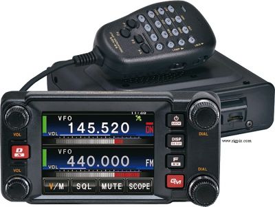

GENERAL
RX: 108-1000 MHz
Tuning steps:5 / 6.25 / 8.33 / 10 / 12.5 / 15 / 20 / 25 / 50 / 100 KHz
Channels/memory management:1000 regular with alpha tags (500 per band)
2 home channels (1 per band)
9 PMS
Power supply:11.7-15.8 VDC
Current drain/power consumption:RX: 500 mA
TX: Max 12 A
Antenna impedance/connector:50 ohms / SO-239
Dimensions (W*H*D):Transceiver: 140*40*125 mm (5.5*1.6*4.9")
Controller: 140*72*20 mm (5.5*2.8*0.8")
Weight:Total: 1.2 Kg (2.64 lbs)
Other features:Large 3.5" color touch screen. APRS functions. Packet 1200/9600bd ready.
Spectrum scope. ARTS. Built-in GPS. Micro-SD card. Twin RX
RECEIVER SECTION
Receiver system:Double conversion superheterodyne
1st IF: 47.25 MHz (A-band), 44.85 MHz (B-band)
2nd IF: 450 KHz
Sensitivity:140-150 MHz: 0.2 uV (12 dB SINAD)
420-470 MHz: 0.2 uV (12 dB SINAD)
Selectivity:AM/FM: 12 KHz (-6 dB), 35 KHz (-60 dB)
Image rejection:
AF output power/speaker:3 W at 10% distortion / 8 ohms (internal speaker)
External speaker connector:3.5 mm
TRANSMITTER SECTION
RF output power:Hi: 50 W
Mid: 20 W
Lo: 5 W
DV: 4FSK/C4FM
NFM: ±2.5 KHz
Spurious emissions:Less than -60 dB
Microphone impedance/connector:2 Kohm / 8-pin (modular)
MISCELLANEOUS
New price 2015 in Sweden: 6495:- SEK
1237
100
[ 此帖被BD3RJ在2016-04-17 10:27重新编辑 ]
