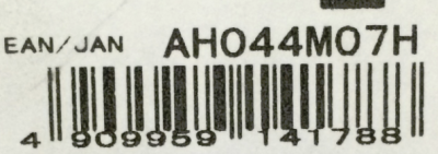

新入手ft1d,就想着和8dr一样扩频,但是ah029m这个命令无效,而且也米有对应按键,后来在开盒子拿数据线的时候无意中看见几个字:“AH044M",一下茅塞顿开,对应着8dr盒子上面的:”AH029M",就觉着这次应该是这几个字母AH044M组成的,但是按键组合是什么还没试出来,把思路说给大家,集思广益

我在www.mods.dk上看到资料.扩了TX 140.000 - 174.000 and 420.00 - 470.000 MHz.
我的买来也就是这个频率

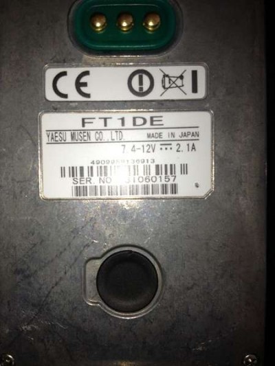

If you remove the battery and the small round plastic cover you will notice a switch and a jumper, do not touch the switch just remove the jumper.
Put plastic cover back in place and the battery then just press and hold the band when power on the transceiver, the mode will enable TX 140.000 - 174.000 and 420.00 - 470.000 MHz.
All data will be lost and call sign as well.!
Please do this at our own risk i presume no responsibility i did it and it worked !!! :)'

7.4-12v?这机器加13.8-14.4V会有问题吧?
