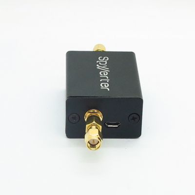

只看该作者 47楼 发表于: 2016-08-14
1HZ-60MHz频率扩展器,371元
The new high performance SpyVerter, extends the reception range down to DC for a gapless DC – 1.8GHz coverage with a superb 10MHz instantaneous view.
HF Specifications:
•NF better than 8dB
•IIP3 > +30dBm
•Minimum RF Input: 1 kHz
•Maximum RF Input: 60 MHz
•IF frequency: 120 – 180 MHz
•Phase noise at 10kHz: -122 dBc/Hz

只看该作者 50楼 发表于: 2016-08-14
回 BG0APD 的帖子
BG0APD:https://item.taobao.com/item.htm?spm=a230r.1.14.50.LRZRsh&id=528313322159&ns=1&abbucket=11#detail (2016-08-14 18:03)
http://airspy.com/spyverter/

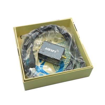

只看该作者 51楼 发表于: 2016-08-14
AirSpy Mini要便宜一些,但国内没上市。
Overview
High Performance Miniature SDR Dongle for All !
Airspy Mini builds on top of the successful Airspy R2 architecture to offer an affordable high performance receiver for the VHF and UHF bands. The coverage can be extended to the HF bands via the SpyVerter up-converter companion.
This new addition to the Airspy family is 100% compatible with all the existing software including the de facto scanning standard SDR#, but also a number of popular software defined radio applications such as SDR-Radio, HDSDR, GQRX and GNU Radio.

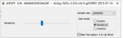

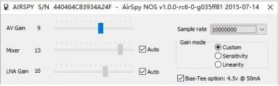

只看该作者 55楼 发表于: 2016-09-19
HDSDR最新AirSPy的dll文件。
extio_airspy_cmake_mgw-v1.0.4.rar (491 K) 下载次数:12
可以调整上变频器LNA增益,插件最下方的bias-Tee option 4.5V@50mA可以选择AirSpy通过同轴电缆为SpyVerter上变频器提供电源,而不需要另外通过MicroUSB接口供电,使得连线更加简洁。

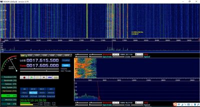

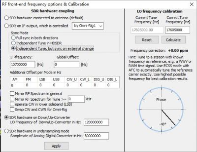

只看该作者 56楼 发表于: 2016-09-19
设置,HDSDR工作正常。

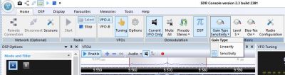

只看该作者 57楼 发表于: 2016-09-19
2381的SDR console 2.3版本自动识别AirSpy,可以设置上变频器本振频率为UP120MHz

只看该作者 59楼 发表于: 2016-09-19
与HDSDR相同,SDR console 内置了AirSpy的参数调整。
但没看出线性和灵敏度两个选项有什么区别
