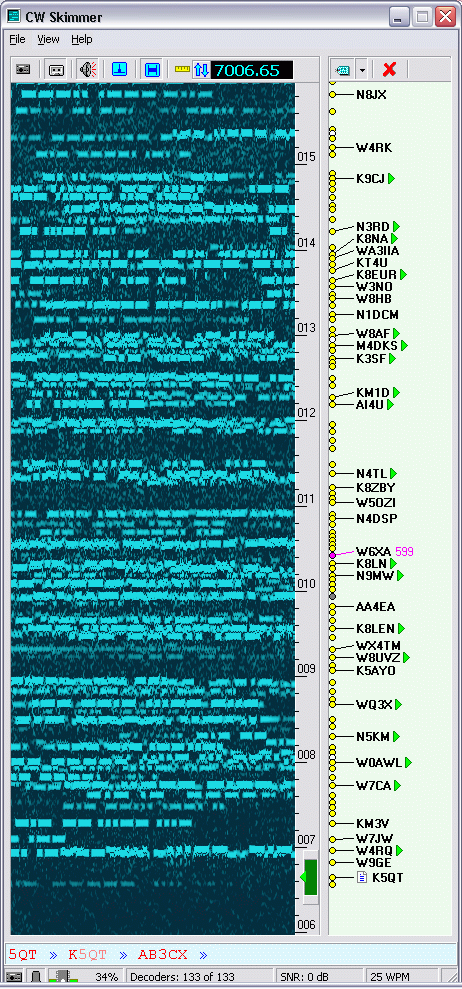

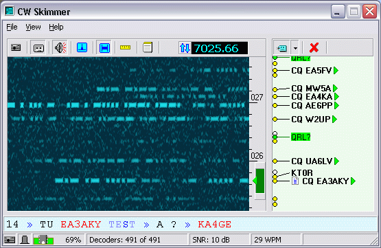

软件推荐:CW Skimmer 1.0 [复制链接]
离线BD3RJ
18844
只看楼主 倒序阅读 0楼 发表于: 2008-03-09
contest, 3-khz mode
功能
a very sensitive cw decoding algorithm based on the methods of bayesian statistics;
simulatneous decoding of all cw signals in the receiver passband - up to 700 signals can be decoded in parallel on a 3-ghz p4 if a wideband receiver is used;
a fast waterfall display, with a resolution sufficient for reading morse code dots and dashes visually;
the callsigns are extracted from the decoded messages, and the traces on the waterfall are labeled with stations' callsigns;
a dsp processor with a noise blanker, agc, and a sharp, variable-bandwidth cw filter;
an i/q recorder and player.
