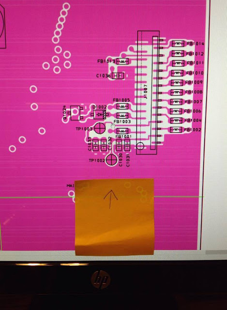

The next connections are to provide DC power and DC ground to the PAT board.  Towards the bottom edge in the middle of the PAT board, there are two solder pads. The one closest to the bottom is for ground and the one above it is for DC power.
The technical supplement for the FTDX-1200, indicates there is an RX9 line that terminates on the main board at TP1002.  A connection to TP1002 will provide 9 volts DC to the PAT board during receive. The ground wire from the PAT board can be soldered to any convenient DC ground point.
Location Area of TP1002 on the main board...
Component side board layout, showing DC positive RX9 point on the main board (TP1002).  (Facing the front of the radio).
