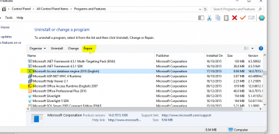

If, after running the Migration Release of HRD, you find all your Award values are set to 0 (zero), please click on the following link to download and install a new Access Database Driver.  Once installed, reboot your computer and all your awards should appear as normal.
https://www.microsoft.com/en-us/download/details.aspx?id=39358
Some users have reported that they have had to install the Access 2007 runtime.   Install only this version if you are running 6.3.x.x and are experiencing the issue. - (due to lack of 32 bit ODBC driver)
https://www.microsoft.com/en-gb/download/details.aspx?id=4438
If you have recently installed or updated a Microsoft Office 64 bit suite,
then do a repair of the MS Access components from Add/Remove Programs , or re-install MS Access runtimes from the links above.
总之 碰到 ACCESS引擎出错,修复 “Microsoft Access Runtime (English) 2007” 针对其修复都能得到解决。
本次Office365自动升级造成 影响ODBC32 得以修复。 供大家参考.....!
后记 --  看样子不得不 切换更好的Logging软件,Access已经到限度 HRD也只能是舍弃 比如换Log4OM类.....
