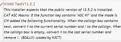

关于N1MM不能向机器串口发送序列号的问题,我已经向n1mm报告了BUG,希望能够解决这个问题
{CATA1ASC KY {SENTRSTCUT} {EXCH} {EXCH};}   这里的EXCH在机器上显示一个#号
到处游荡的机器人火腿,目前在丽江
RIG:我有一堆uSDX
ANT:随时都能抄走的拉杆GP天线
离线BG6JJI
4951
只看该作者 9楼 发表于: 2013-05-24
Jerry,
I made a change to the code and posted a link to an experimental software
installer at the link below.
The installer expects that you have the public version of 13.05.02
installed.
Change your function key message to the string below and test the code.
{CATA1ASC KY 5NN # #;}
Let me know how the code works. It will add leading zero's if you have the
option set in Configurer, Function Key tab.
Using the KY command set to send CW is limited. I recommend that you add a
CW interface or WinKey. Either are a simple addition.
John, K3CT

只看该作者 10楼 发表于: 2013-05-24
试了,不行啊
到处游荡的机器人火腿,目前在丽江
RIG:我有一堆uSDX
ANT:随时都能抄走的拉杆GP天线
离线BG6JJI
4951
只看该作者 11楼 发表于: 2013-05-25
http://n1mm.hamdocs.com/tiki-list_file_gallery.php?galleryId=20
经过跟作者的一晚上2天的沟通,不能发序号这个问题已经修复了,请大家放心用吧!!!
记得下载上面的那个版本
