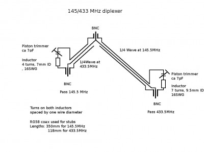

总之,原理是,利用电感、微调电容与盒子里的馈线形成四分之一波长的短截线,利用短截线来滤波。微调电容可用来不同频点。
On the left hand side of this circuit diagram a 433MHz 1/4 wavelength coax stub is indicated that is effectively short circuited at the outlet end by a series resonant L/C circuit tuned to 433MHz. This arrangement presents a very high impedance for 433MHz signals at the input (ie top connection) of the device, but will freely pass 144MHz signals. Similarly on the right hand side of the diagram, a 144MHz 1/4 wavelength stub is indicated terminated with a series resonant L/C circuit that is tuned to resonate at 144mHz. This side of the circuit will block signals at 144mHz, but will pass 433MHz signals unhindered.
Dimensions for the 1/4 wavelength stubs are given, but depending on the particular coax cables used, some experimentation might be needed, especially for the 433MHz stub. This isn't too difficult. My procedure for setting up this diplexer was as follows:
1. Connect low power transmitter with SWR meter to the input connector.
2. Connect 50Ω dummy loads to output connectors. Dummy loads can be two small 100Ω resistors connected
   in parallel across a BNC plug.
3. Adjust the trimmer capacitors for minimum SWR readings.
4. If SWR readings close to 1:1 cannot be obtained then try using slightly different stub lengths. It was fairly easy
   to find the optimum length for 144MHz. The 433MHz stub length was more critical.

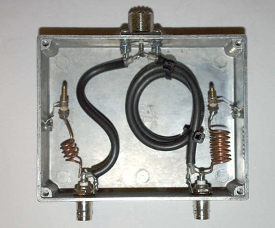

I built this diplexer into an aluminium die cast box as shown on the left. The device continues to work very well, giving very low SWR readings on both bands.

可调电容安置上为什么不转个口固定在盆上便于
调节?
再就是如果谐振点调好后,用电容表分别测量两个可变电容值,
用固定电容替代!

老外真的好聪明,左433串联谐振,就成为433  4分之一波长远端短路,变为433   4分之一波长近段端无穷大阻抗,,对于433来说断路,论坛里4分之一波长同轴线做陷波器也是这个原理,J型天线也是这原理,右边145也是这个原理。
